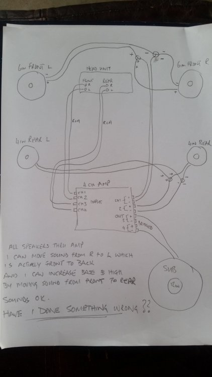

Matt9ball Posted September 20, 2018 Author Report Posted September 20, 2018 What u guys think of this setup. Have i done something stupid? This allows me to take a little off the smaller rear speakers by shifting to the right and allows me to add base or treble by moving to the front and rear.
MrSkippyJ Posted September 20, 2018 Report Posted September 20, 2018 That would sound terrible. Keep it simple, run the front speakers on channel 1 & 2 using the front RCA output. Run the sub bridged on 3 & 4 using the SUB RCA output. The rears you can just ignore or use the headunit power. F150: Stock 2019 Harley Road Glide: Amp: TM400Xad - 4 channel 400 watt Processor: DSR1 Fairing (Front) 6.5s -MMats PA601cx Lid (Rear) 6x9s - TMS69

MrSkippyJ Posted September 21, 2018 Report Posted September 21, 2018 your front speakers would be playing the right signal and your rear speakers would be playing the left. F150: Stock 2019 Harley Road Glide: Amp: TM400Xad - 4 channel 400 watt Processor: DSR1 Fairing (Front) 6.5s -MMats PA601cx Lid (Rear) 6x9s - TMS69
