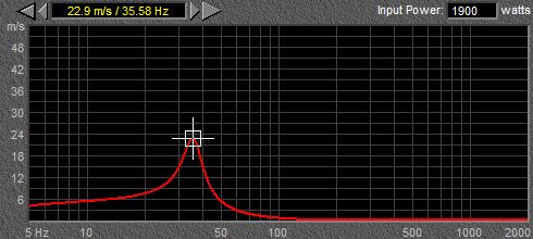

MarcoPT Posted October 1, 2018 Report Posted October 1, 2018 hey there this is my 3rd box build but the first slot ported... my question is, port area, im at around 23sq in per cube do i need do worry or its ok? the box is for a single 12", a DB sa2712 , im giving it around 1.8k/ 1.9k of power, they recomended 1.9cft but im going with 2cft tune to 36 or 38hz, still deciding... port air speed at 36hz peaks at 55 ft per sec at 32hz port air speed at 38hz peaks at 56 ft per sec at 35hz now my box desing leave me with this port is 3.54 x 13.40 in i could go a bit larger like 4 in to get air speed down to 42ft per sec but it will but up the port area to around 26.7 sq in what would be the best option? if port area at 26.7 isnt a problem i can go 4 in and lower the air speed..... just dont want to lose cone control i like to keep the box on the small like 2 cubes after sub and port displacement

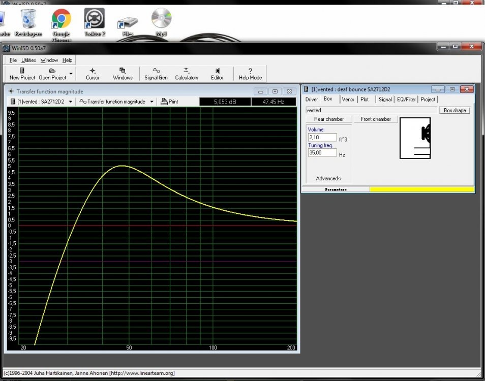

MarcoPT Posted October 1, 2018 Author Report Posted October 1, 2018 i like to tune around the fs of the sub to help kep the cone control (correct me if im wrong), that why my lowest tune started at 35 that i go up as go larger to get a nice compromisse betwen air velocity, port area and tune.... with that air velocity u dont get port noise? thats my afraid, my first desing i had a port with 2.75 in but the air velocity was very high, and i dont want port noise, u get me? the mdf or plywood is very expenssive i want to get it right the the first time lol this is a dally system guys not for spl competicion but yes im a bit of a bass head i want a nice spl but a nice sq too, and i want to be able to play every tipo of music... my corrent sub is a dual 12" pioneer 400 rms each 2 cubes per sub tune to 34 round port form dls and sound great, but i need space... thats why 2 week sub out 1 powerfull in... im setting subsonic somewere between 25 and 30hz my tune curve:

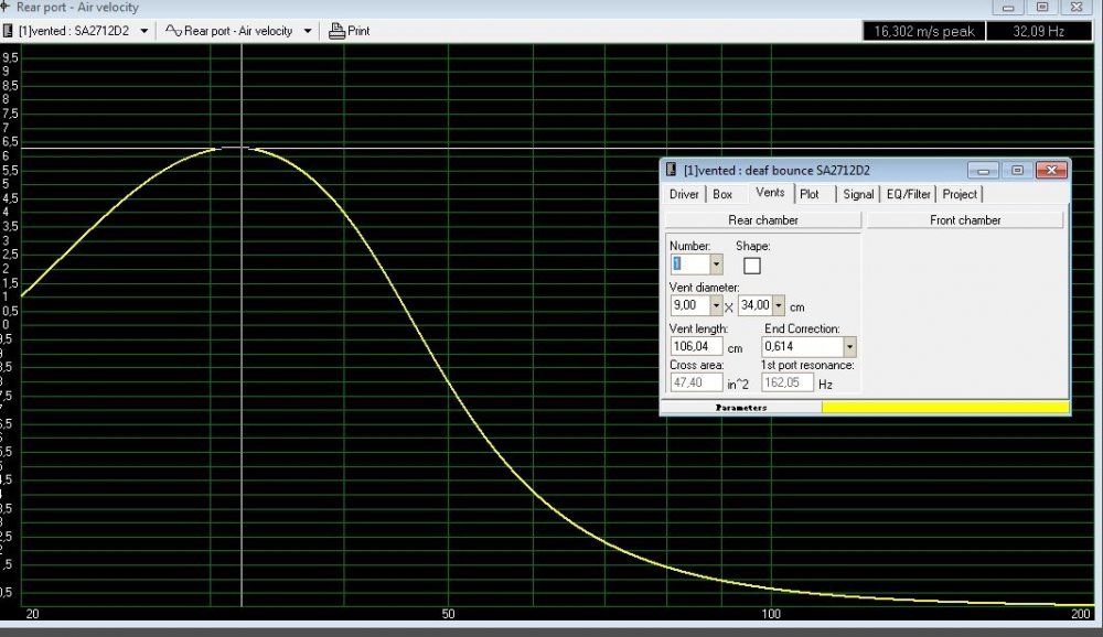

Joe X Posted October 1, 2018 Report Posted October 1, 2018 5 hours ago, MarcoPT said: hey there this is my 3rd box build but the first slot ported... my question is, port area, im at around 23sq in per cube do i need do worry or its ok? the box is for a single 12", a DB sa2712 , im giving it around 1.8k/ 1.9k of power, they recomended 1.9cft but im going with 2cft tune to 36 or 38hz, still deciding... port air speed at 36hz peaks at 55 ft per sec at 32hz port air speed at 38hz peaks at 56 ft per sec at 35hz now my box desing leave me with this port is 3.54 x 13.40 in i could go a bit larger like 4 in to get air speed down to 42ft per sec but it will but up the port area to around 26.7 sq in what would be the best option? if port area at 26.7 isnt a problem i can go 4 in and lower the air speed..... just dont want to lose cone control i like to keep the box on the small like 2 cubes after sub and port displacement So I modeled for your DB sa2712 a box 2 net @ 36Hz with 40 raw square inches of port area and 1900W power: } That should be enough at least for a daily setup, if you are worried for an inaudible 0.3 dB gain you may take a second look, now if you are doing a very long port with many turns that's not going to help your cause either.

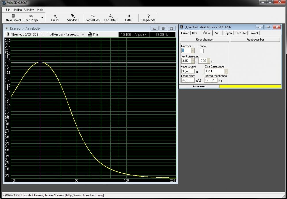

MarcoPT Posted October 1, 2018 Author Report Posted October 1, 2018 how this s looking? port air velocity 18.18 m/s at 30hz port area at 21 per cube tune to 35hz looks nice, i think lol
Joe X Posted October 2, 2018 Report Posted October 2, 2018 42 square inches of port area like you have will be just fine.
