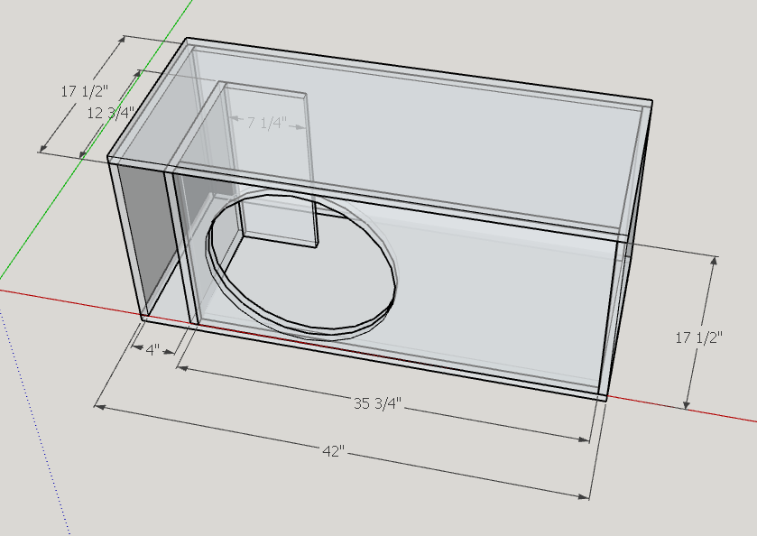

spyder_2003 Posted December 20, 2018 Author Report Posted December 20, 2018 i have 42 inches wide 24 inches long and 19 inches tall available

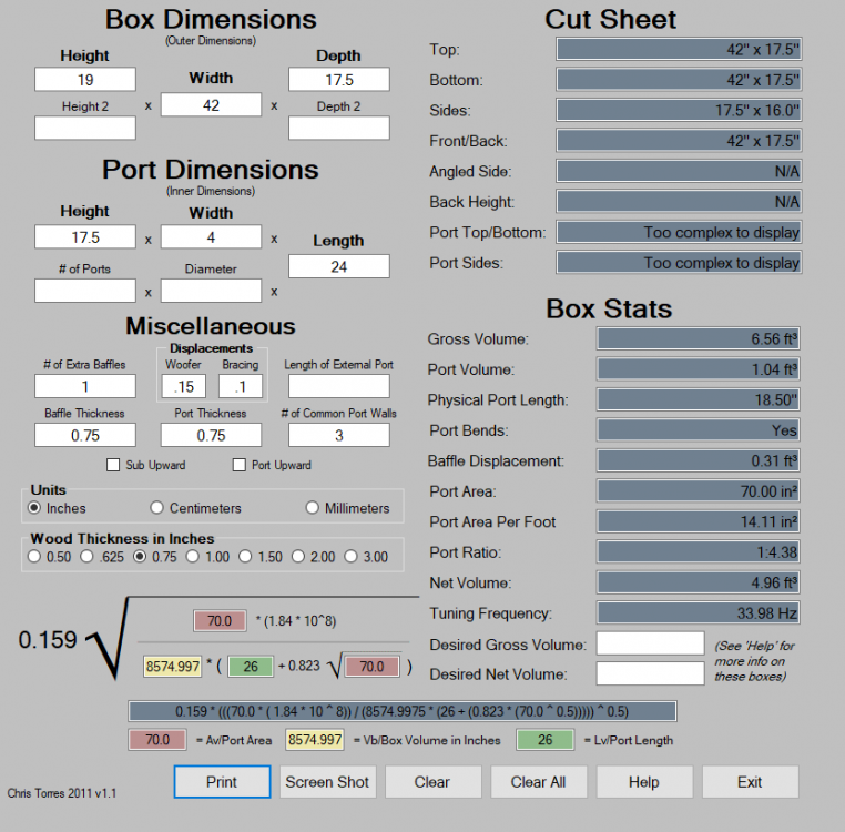

Triticum Agricolam Posted December 20, 2018 Report Posted December 20, 2018 1 hour ago, spyder_2003 said: i have 42 inches wide 24 inches long and 19 inches tall available Since you can go 19", you can fit that 18" on the front face, which makes things a lot easier. Looking at your pictures, I think this is the sub you have: https://www.seismicaudiospeakers.com/collections/raw-subwoofer-drivers/products/18-inch-raw-subwoofer-driver-speaker-18 Unfortunately the manufacturer gives almost no info on it, so all I can do is give you generic 18" sub box specs. Here is something that would work: And here is how you would lay that out: I didn't include any bracing in the drawing and a box this size should definitely have bracing. This is a pretty generic specced box for an 18" sub, that way when you let the magic smoke out of your current sub you should be able to drop a higher quality 18" in there and be reasonably good to go. "Nothing prevents people from knowing the truth more than the belief they already know it.""Making bass is easy, making music is the hard part."Builds:
