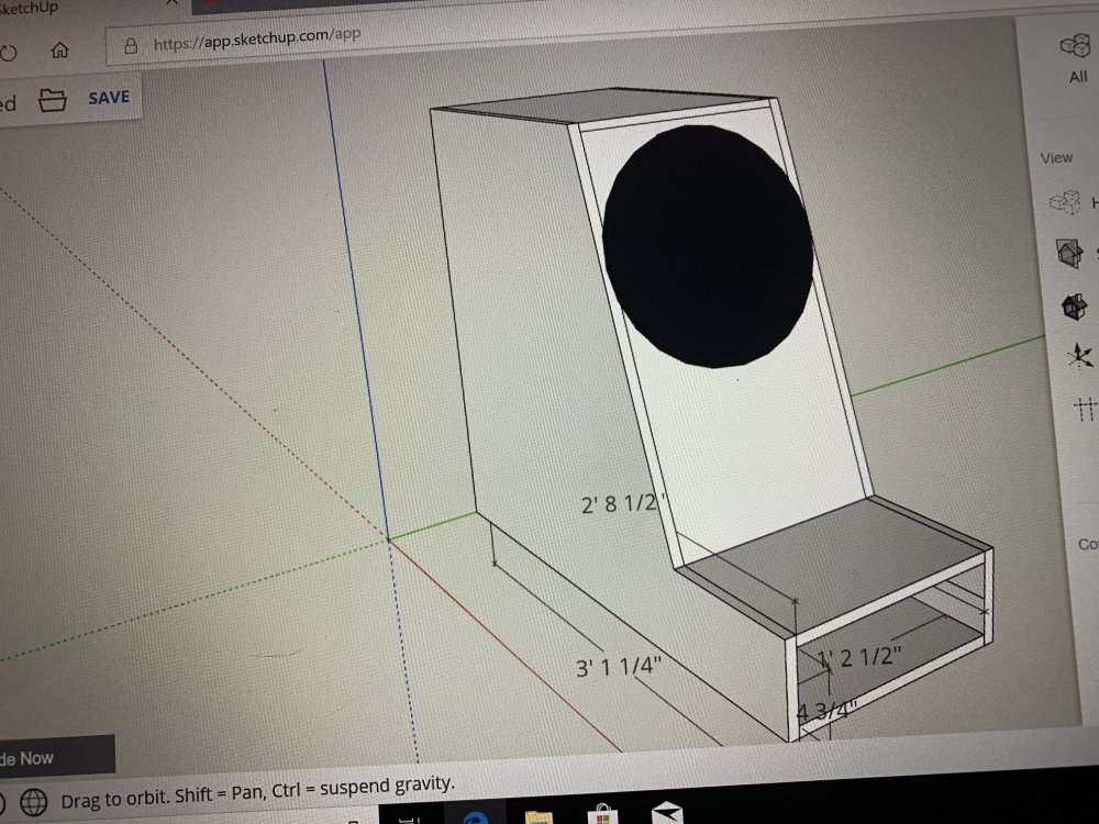

Attempted to try sketchup, box for 2014 ram crew cab.
06RTCharger

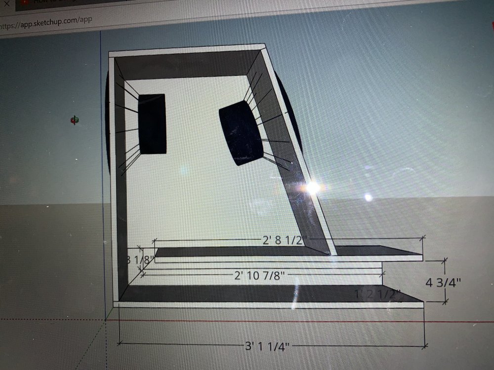

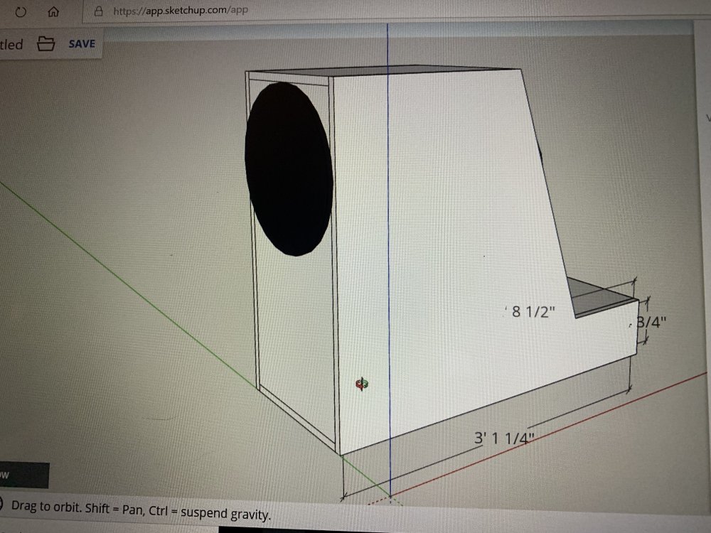

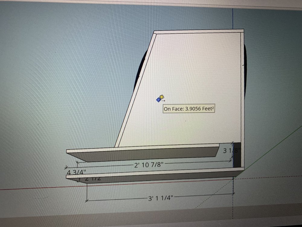

After port displacement i got 4.72cubes. Still need to deduct for bracing and subs though. But im going to build a test box for now to see if i can figure out a more precise plan. So i got some cheap ply wood at Lowes earlier and ill try to build this box tomorrow(today)

Nice job on the design of the box. Looks good. I'm going to have to check out that program you are using.

Yah it was kinna hard to figure it out and figure out how to use it. This is only my second time tryna use a 3d design type of thing. It is cool once u figure out the tools u can use.
The issue i have also is i dont know shit about ports lol so i have to rely on the calculators online. And the calculators always want "net volume", but how am i supposed to know the net volume if i have no clue how big the port will be yet? Lol, idk maybe im too noobie still but i feel like im being asked a trick question by a teacher with that part of the calculators.
Maybe they want net volume of the box and then they give u dimensions of an external port? Idk im about to start on this thing tho, good luck with yours.
