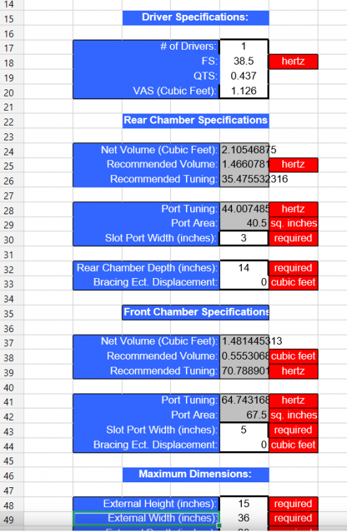

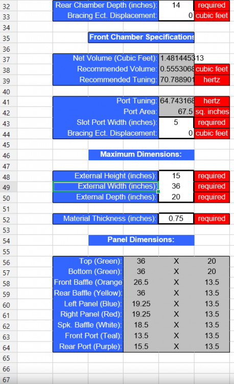

been looking for software or a calculator to design  6th order fro my xfl.  this is what I found,   http://dbdynamixaudio.com/on-axis-6th-order-parallel-bandpass-enclosure-calculator/
I know the re calculator is flawed, anyone know anything about this one? I'm not even sure what I'm supposed to be inputting besides driver specs and external dimensions.  I don't even see a place to enter woofer diameter!

WinISD can model parallel-tuned 6th orders, BassBoxPro and HornResp can model parallel-tuned and series-tuned 6th orders.
