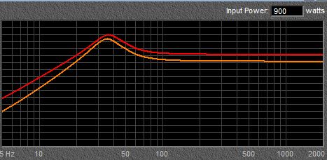

mfdoom7 Posted January 21, 2019 Author Report Posted January 21, 2019 http://edgecaraudio.com/en/subwoofers/edb12d2x-e7 or http://edgecaraudio.com/en/subwoofers/edb15d2x-e7
Joe X Posted January 21, 2019 Report Posted January 21, 2019 The 15" is the red plot on 3 net The 12" is the orange plot on 2 net These are compared on the same 900W power but the 15" can take 1100 RMS so it can even perform better. In this case I would go for the 15" as long as you can fit a proper box in your vehicle.
