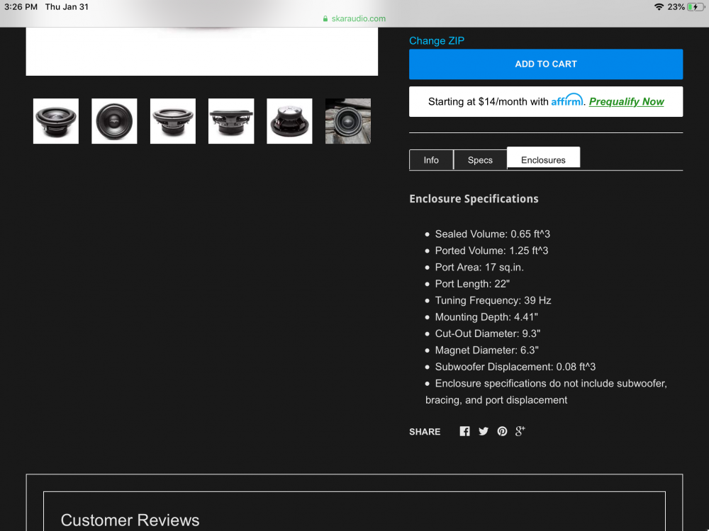

I have a 2010 Toyota Tundra Double Cab. I’m wanting to add a box from
https://www.netaudiowf.com/product/2007-13-toyota-tundra-double-cab-sub-box-downfire-dual-ported/
The box is 1.5 cu ft and can either be sealed or ported.  Not sure if the Skar Audio VD subs would work in this box due to air space. Ideas?
I’m wanting to do 2 10’s or 3 8’s sealed or ported.

That’s Skar VD 10 specs , looks like 2 sealed should work accept I don’t understand what the box is talking about for 5inch mounting depth with mounting back plates, U need 4.5inches of depth. U could build your own for half that price.
