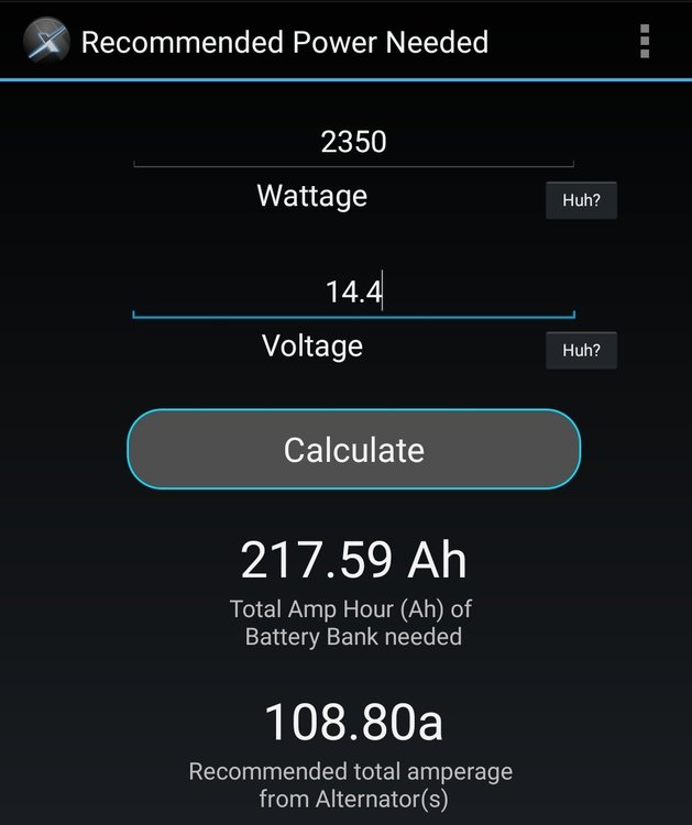

FTJack Posted April 14, 2019 Report Posted April 14, 2019 I have a 2004 GMC DENALI XL 6.0 and I'm installing 2 sets of JL Audio Zr650csi one set I will add a JL Audio C5-400cm, a set of JL Audio C2-350X, and a Alpine R-W10D4 sub woofer. I will be using Rockford T800-4ad, T600.4, R150X2, and T1000.1BD to power all my speakers. If my calculations are right the amps should be putting out 2100 watts. My question is do I need to add a high output alternator if so what size? Do I need to add a secondary battery if so what size?
Mike4068 Posted April 14, 2019 Report Posted April 14, 2019 There's a free app called ultimate car audio app that has calculators for this very thing. They have a paid version too and have stopped supporting the free version but the calculators still work. Pretty handy. Hope this helps.
FTJack Posted April 14, 2019 Author Report Posted April 14, 2019 47 minutes ago, Mike4068 said: There's a free app called ultimate car audio app that has calculators for this very thing. They have a paid version too and have stopped supporting the free version but the calculators still work. Pretty handy. Hope this helps. I used the app and this is what the output is. So what secondary battery has this amount of Ah?
Mike4068 Posted April 14, 2019 Report Posted April 14, 2019 I use northstar batteries. The smsagm480 is 210 ah. It's an $800 battery. A couple of group 31 agm batteries would get you there. Shop around for the best price. Takes power to make power and it is not cheap. The electrical upgrades are just as expensive if not more than the equipment. A lot of people don't realize that when planning a build.
