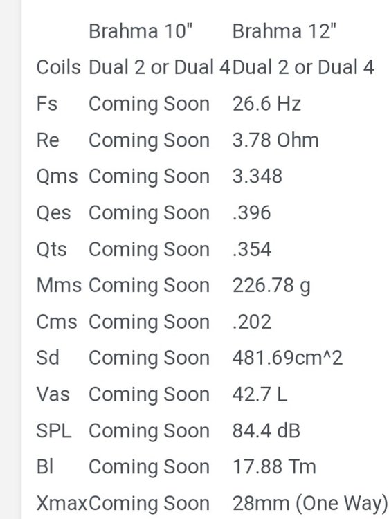

Sealed boxes aren't real sensitive to changes in volume.  Within reason, bigger is usually better as long as you still keep cone excursion under control.  With the amount of power you will be running that won't be a problem at all.
I'd shoot for 1.0 - 1.5 cu ft.

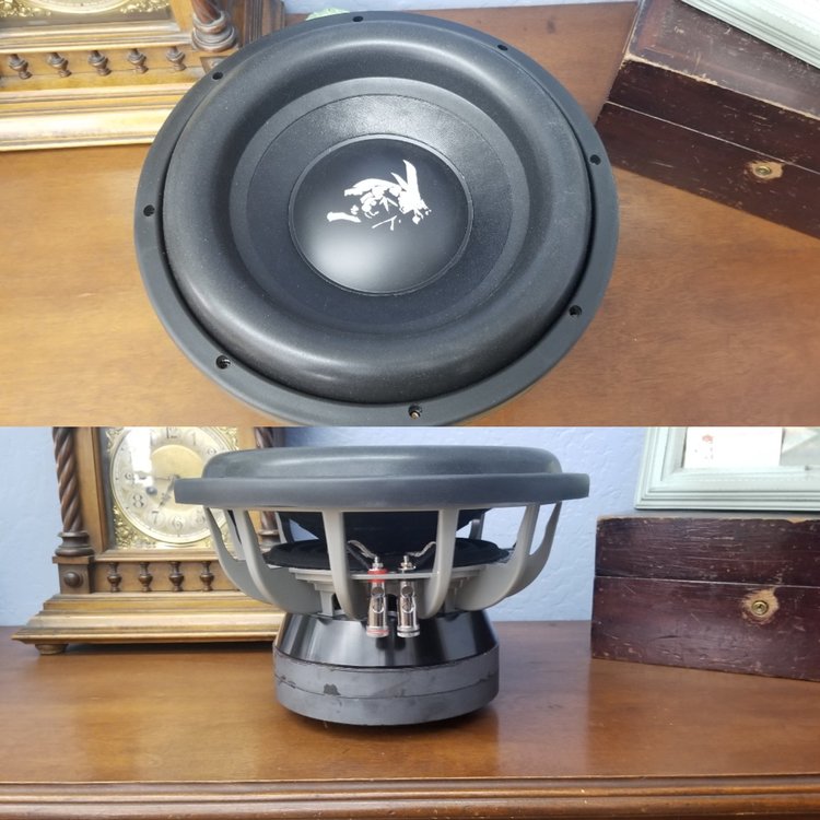

is this the new brahma? (just curious)
Sure is

Ok perfect.  I dodnt want to make it to big and risk something.  My plan was about 1.25 cubes gross which gives the sub anout 1.1 net sealed

That should work great.
