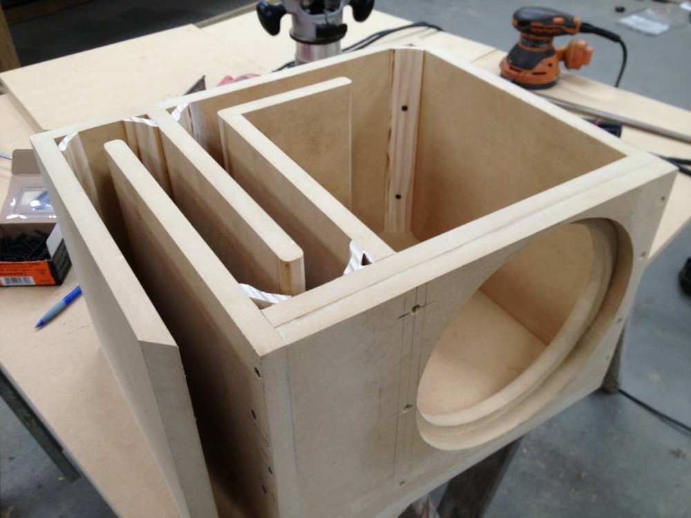

ToNasty Posted July 1, 2019 Author Report Posted July 1, 2019 1 hour ago, Triticum Agricolam said: I've been using that sub in my home theater setup, they are awesome subs. I'd suggest a 1.2 cu ft box tuned to 30 Hz. 17 sq in of port area, the port will have to be long. Id have to do a port like shown below. My configuration would be center console since its a regular cab with sub firing at the back wall and port firing forward under the dash. If you underdtand what i mean This os an sq build and my midbass will br crossed somewhere in the 70-80hz region ***Super Sellers List***http://www.stevemeadedesigns.com/board/topic/25829-super-sellers-buyers

Triticum Agricolam Posted July 1, 2019 Report Posted July 1, 2019 6 hours ago, ToNasty said: Id have to do a port like shown below. My configuration would be center console since its a regular cab with sub firing at the back wall and port firing forward under the dash. If you underdtand what i mean This os an sq build and my midbass will br crossed somewhere in the 70-80hz region I don't see any issue with using a labyrinth style port like this for your particular application. There can actually be some sound quality benefits to using a labyrinth port and since you aren't going for crazy SPL I don't think you will have any issues with it. Based on the port calculator I use, a 1.375" x 13.5" will need to be 38" long to tune 1.2 cu ft to 30 hz. Its long, but not unreasonable. "Nothing prevents people from knowing the truth more than the belief they already know it.""Making bass is easy, making music is the hard part."Builds:
ToNasty Posted July 1, 2019 Author Report Posted July 1, 2019 3 hours ago, Triticum Agricolam said: I don't see any issue with using a labyrinth style port like this for your particular application. There can actually be some sound quality benefits to using a labyrinth port and since you aren't going for crazy SPL I don't think you will have any issues with it. Based on the port calculator I use, a 1.375" x 13.5" will need to be 38" long to tune 1.2 cu ft to 30 hz. Its long, but not unreasonable. Defnetely doable. And yes this is an SQ build. I need it musical not loud. Of course I like my bass and want to hear it. But I know I have to sacrifice a little output. No I just need to find someone to model this for me. So I can get building. (I dont have a computer at the moment. All this is done on my phone ***Super Sellers List***http://www.stevemeadedesigns.com/board/topic/25829-super-sellers-buyers
