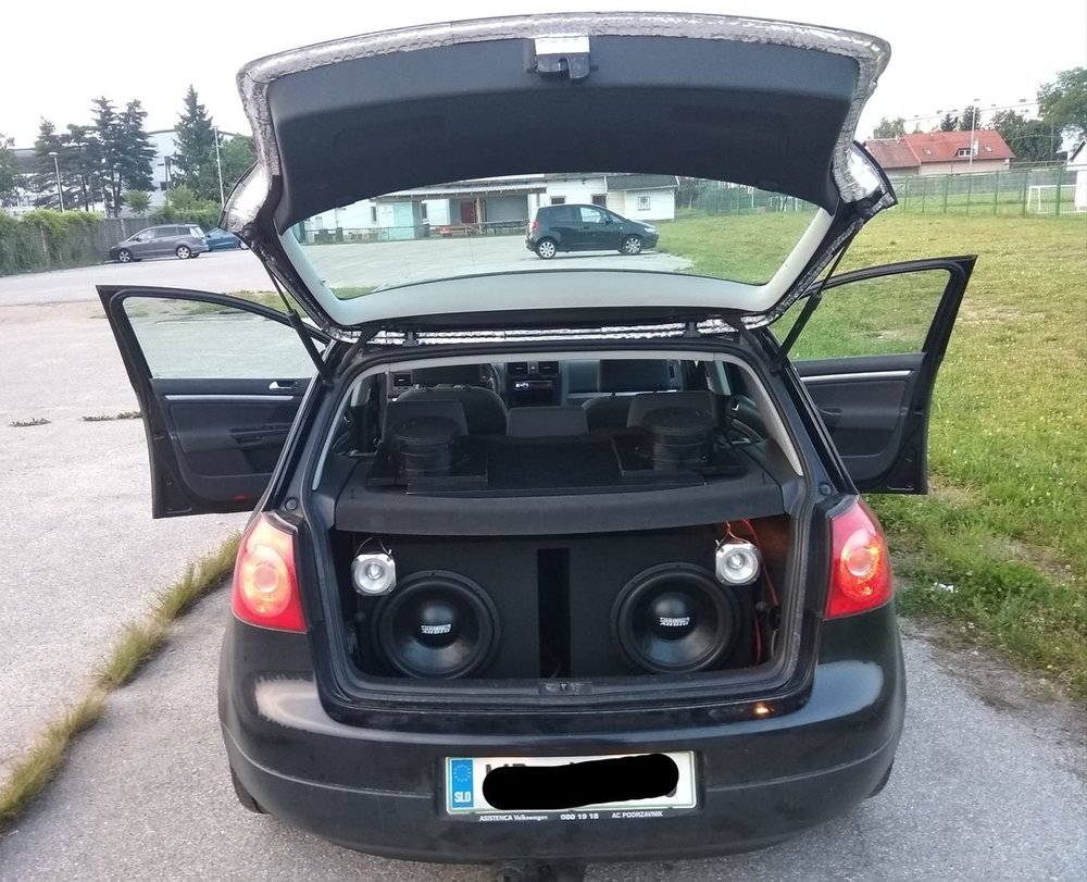

Hello, one question.. i have 2 sa 12s with great sound quality at 35 hz tuning, 40cm x 7,5 cm slot port in the middle and 5 cubes total net volume.. car peaks at 60 hz..  box at 38... my score is highest at 60hz.. if i model the enclosure in winisd, i need a tuning of 57 hz to be able to get 8dB gain at 60 hz.. in theory... so.. is it possible (just for testing purposes and fun).. to put something in the box to lower the volume for half.. and so raise my tuning and test if numbers really go up at 60 hz? if possible.. what should i put in the box.. bricks of wood? blankets? anything else? if this is even possible.. i am sure its not legit experimenting, but just to see if numbers really go up :) thanks, and don't laugh :p

While reducing the internal volume of your box will raise your tuning, its also going to decrease your output at tuning, so its unlikely you are really going to gain anything.
If you want to try a higher tuning frequency to see if you can get a bigger peak SPL number, you are probably going to have to build another box with a shorter port.  Keep in the mind the higher you tune the more port area you need as well or you will get significant port noise and port compression.
