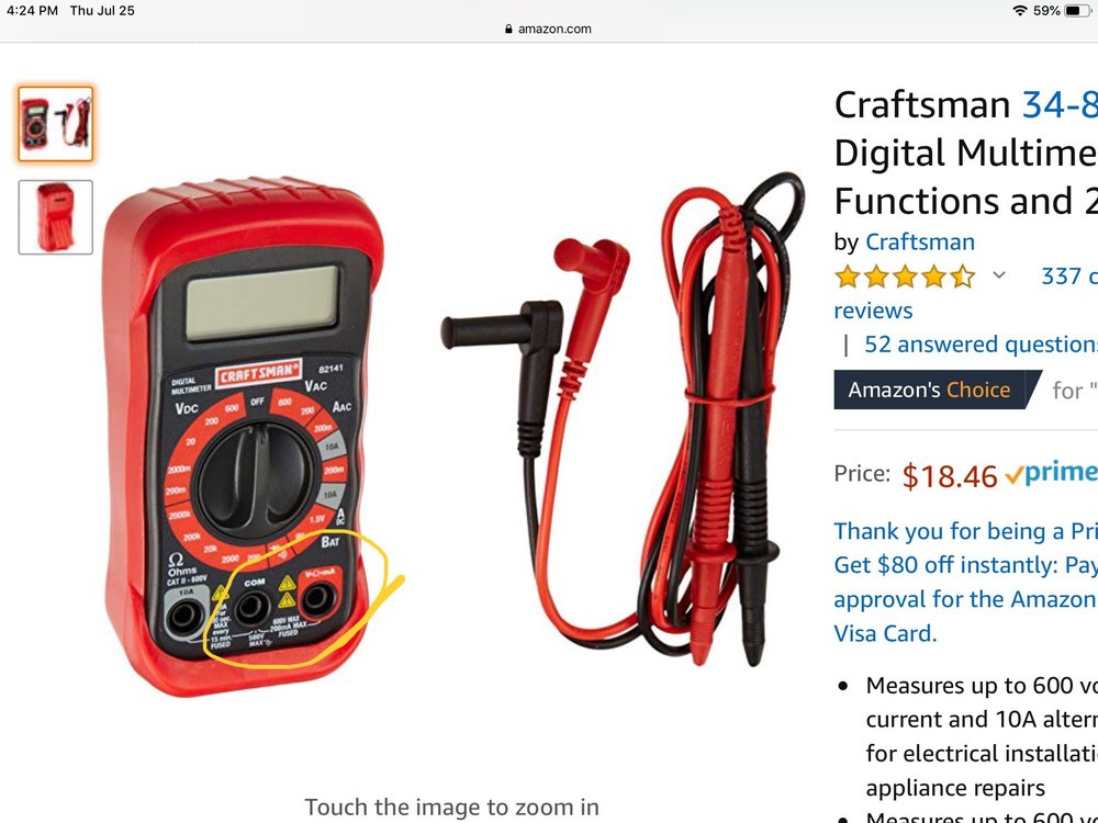

I wired 2 12 dual 2 ohm together. What setting do I use on my craftsman multimeter to measure it? I went to measure it and read a 1.23 ohm while vehicle off. Not connected. It kept jumping  from 1 to between. 1.5

Are U looking for 1ohm , Remember before measuring the subs touch the 2 leads together and subtract that number to your reading on the subs it won’t be much but always something . Use the 200 ohm scale.
Red and black 200 ohms scale not the 200k
2 on the right side the one one the left is for an amp clamp
