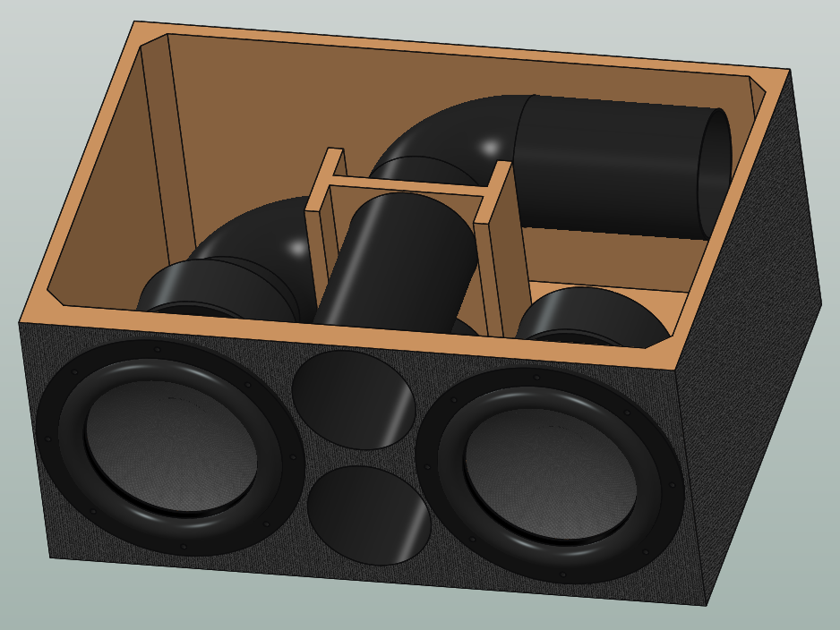

Here is what I currently have with 6" ports. I don't have all of the bracing for the ports yet. Would it be better to go with the 2 elbows like the bottom one, or 1 elbow like the top? both come up to the same length. right now these are 28.54" in length. and it is now showing a tune of around 33hz I think. thanks for the help!
Well I guess it has been decided for me. At least if I want the subs and port facing the front and pushed up fairly close the the back seat. I double checked and I only have 32" width MAX at the front base of the box. 6" round ports won't fit. I will need to use a slot port, if my subs and port are facing the front. My trunk is shaped a little funny. I will attach a quick sketch shortly of what I have to work with. Is it best to have the subs and port facing to the front of my car? or would it be better to have them facing another way? I didn't really want to make a funky shaped box, but I will do it or have it done if it is what is going to work best.

Ok so I can barely fit 6" round ports on the front. I am afraid there might not be enough strength doing this though.  as you can see the Subs barely fit with the ports.1008550191_9-5-20192-35-57PM.png.05b99f6054ea813947712072a2e028e4.png
