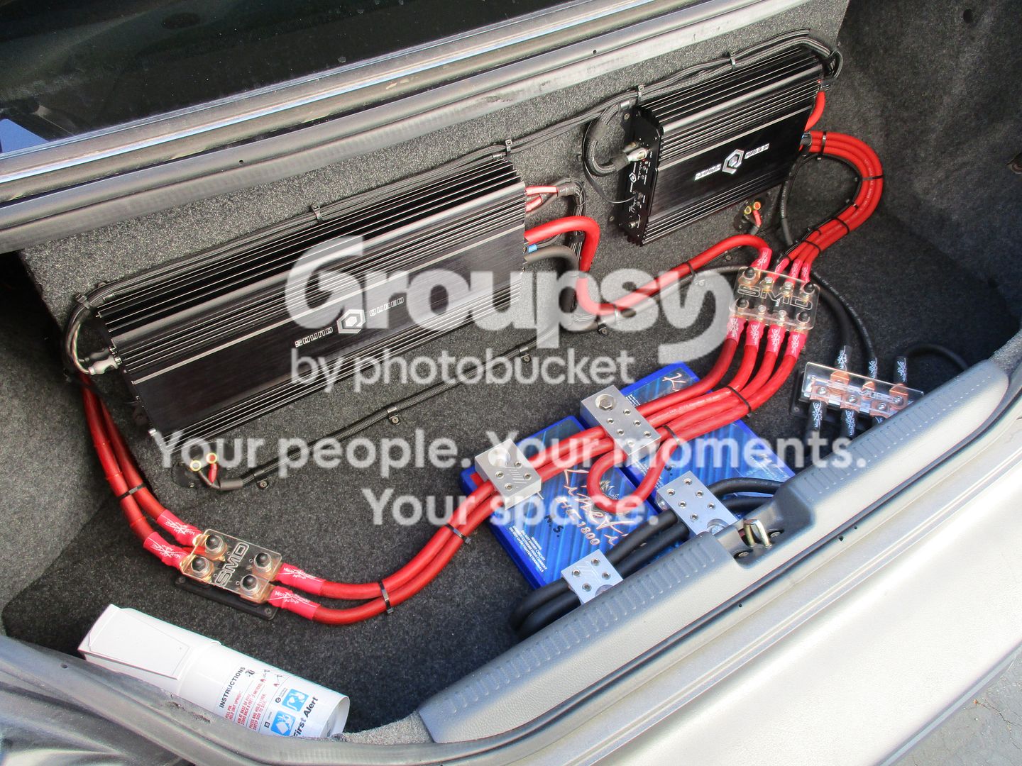

i may look into the c7 and up grade my amp.i also have been looking at the new sundown v2 series and also a few fi subs .i just hate redoing my amps cause i like the matching amp desgins and the other skar amp is the lp-1000
Nice wiring job. Takes some time & $ but sure is worth it IMO. AMPS should always match unless hidden & unseen. I like your OCD-ness sir. lol  I have a touch of it too.
