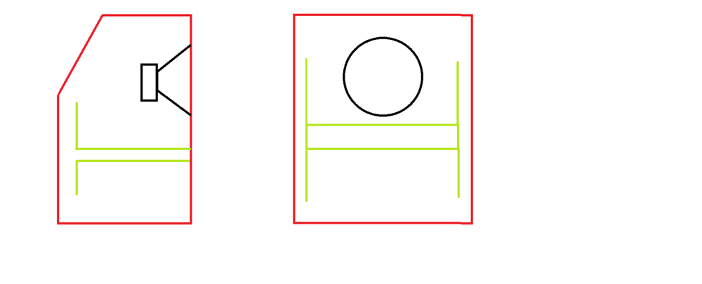

Here the style of the box, where would be the better place for the square port please or doesn't matter ?
Thank's
Thank's, So because of the box size I need to choose the number 2 (under the speaker)

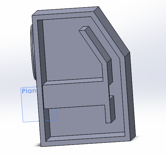

Because of my installation, It would be easier for me to put the port in the middle of the box under the speaker, I need 22.82" of port length, can I do a "T" port ?
I have 3cm of free space each side :
if you do go with a "t" port, youll want a lot of bracing on the port itself.  also make sure you deduct the total volume of the port from the internal volume of your box, if you go with that design.  if possible, try to move the port all the way to the bottom of the enclosure so it shares a common wall with the enclosure.  if that's not possible due to obstructions, can you put it at the top?  it will be much much stronger if you do.
im not an expert by any means, but your latest port confuses me.  what i meant by my suggestion is can you use option #2 from your original post, but put the port all the way on the bottom of the enclosure so that it shares a common wall with the bottom of the enclosure?
Excuse my English... I can put it a the bottom but it was better for me to put it at the middle, the hole in my cab would be smaller.
I put the port all the way to the side to use the common wall

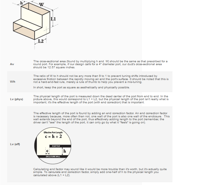

Can you tell me if I ='m wright with how I calculate the leng of the port?
I use this to mesure on my CAD drawing the plans :

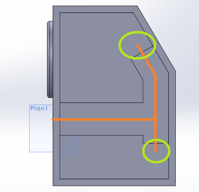

Was that orange line good? I had the lenght I have circled :
