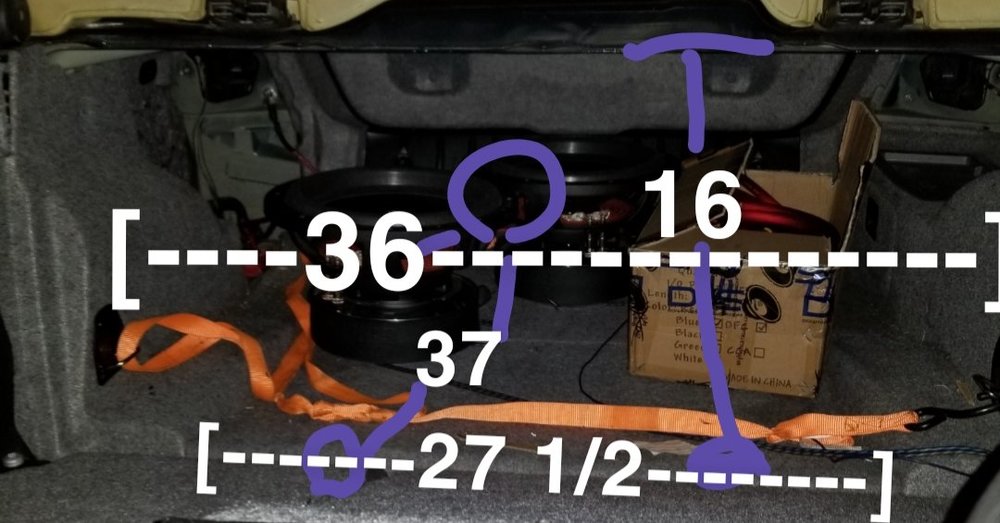

Mr.Lahey Posted December 5, 2019 Author Report Posted December 5, 2019 In inches, is this an accurate way to measure?
