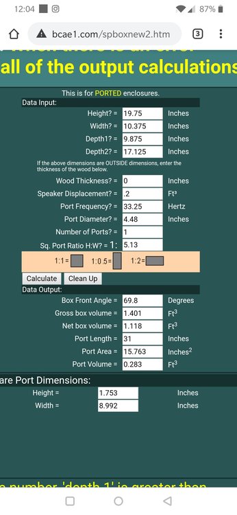

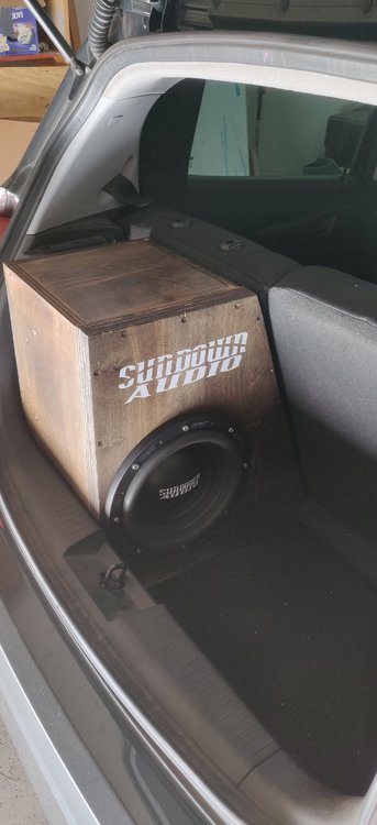

I have a sundown SA10 V2 D4 running on a pioneer GMD9705, sub channel is 2ohm 600w.  I have a 2017 Chevy spark LS and I'm using the factory deck and an audio control LC7I.  I built my own box to fit behind the seat in the hatch.  Based on the calculator I used I should be tuned at 33.25hz.  Here are the box specs:
OD measurements
Depth 12.5" double 3/4" birch baffle
Width top/1 11"
Width bottom/2 19"
Height 21.25"
Port is 9" by 1.75" by 31" long with 2 bends.
ID measurements
Depth 10.375"
Width top/1 9.875"
Width bottom/2 17.125"
Height 19.75"

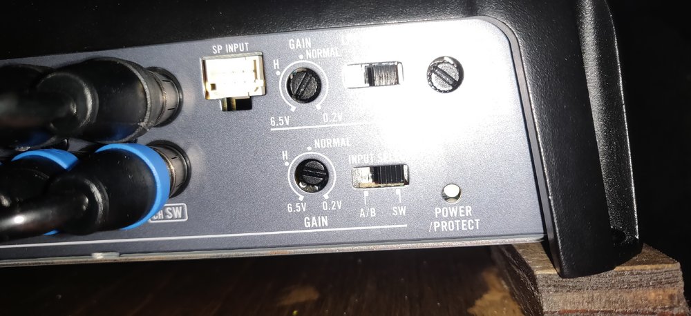

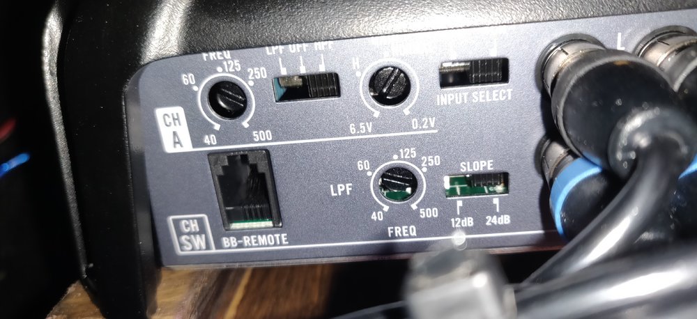

Problem I'm having is I have gone through the audio control settings and set each of the 3 gains until they blink then back it off a bit.  I have tried various settings on bass restoration and level and when playing sign waves my highest peak is 50hz or so and I can feel the sub moving all the way up to 120hz.  Factory equalizer on the stock deck is set completely flat to allow the LC7i to do the restoration work.  Also a picture attached of my amp settings.  I guess what I'm wanting to check is my box built and tuned correctly to be actually tuned at 33.25hz or did I mess something up in my calculations causing the higher frequency output?

Unfortunately that box seems fairly small for how large the port is - granted I haven't ran any of the numbers in my speaker software. the numbers hit me as the port is taking up most of the box space. A ported box is typically 2-3x the size of a sealed box, and then some for the added port.

According to Tores (the program I use) your box is about .8 cubic foot. Sundown recommends 1-1.25 for a ported box, so it's a little on the small side.  Also you have too much port area in my opinion.  My program says your tuning is around 38-39hz.  All that being said, you should still be getting pretty good output with that setup.
Thanks for the comment. When I spoke to down4sound they said the port area was a good size so I went with it I'm at 15.75sq inches.  For the V1 SA sundown reccomends 16sq inches.  Slapbox specs are at 18sq inches  Do you know if the calculator I used is typically accurate?

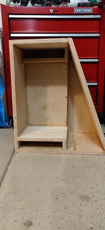

Based on the amp do you think it's capable of playing the 30s well and not lower volume?  It's just not hitting the lows as expected. Did you use the internal dims I posted for your calculations?  I attached a picture before adding the double baffle

I was hoping the box is not too small but I don't have any software for box calculations so I used the one I found online. I posted a picture before the baffle was added to see the port inside.  This is my first box I have ever built so I'm not ruling out the possibility I made a mistake 😁.  I do have enough wood left to build another box if needed.  Is the shape going to affect my output at all? I made it that shape to take up all available space behind the seat with the smallest footprint.

So I was able to turn the volume up today for a bit and ran through a frequency sweep 1hz at a time using an app called "frequency sound generator". I moved 1hz at a time and had the most air movement at 32-38hz and was much less air than I expected.  Least cone movement at 31-32 then the cone movement got faster and started to move more/longer excursion until the 50s then tapered off. I could feel the sub moving up to around the 130s which I find suspicious since I have my LPF at 60hz and switch on 24db at cut.
