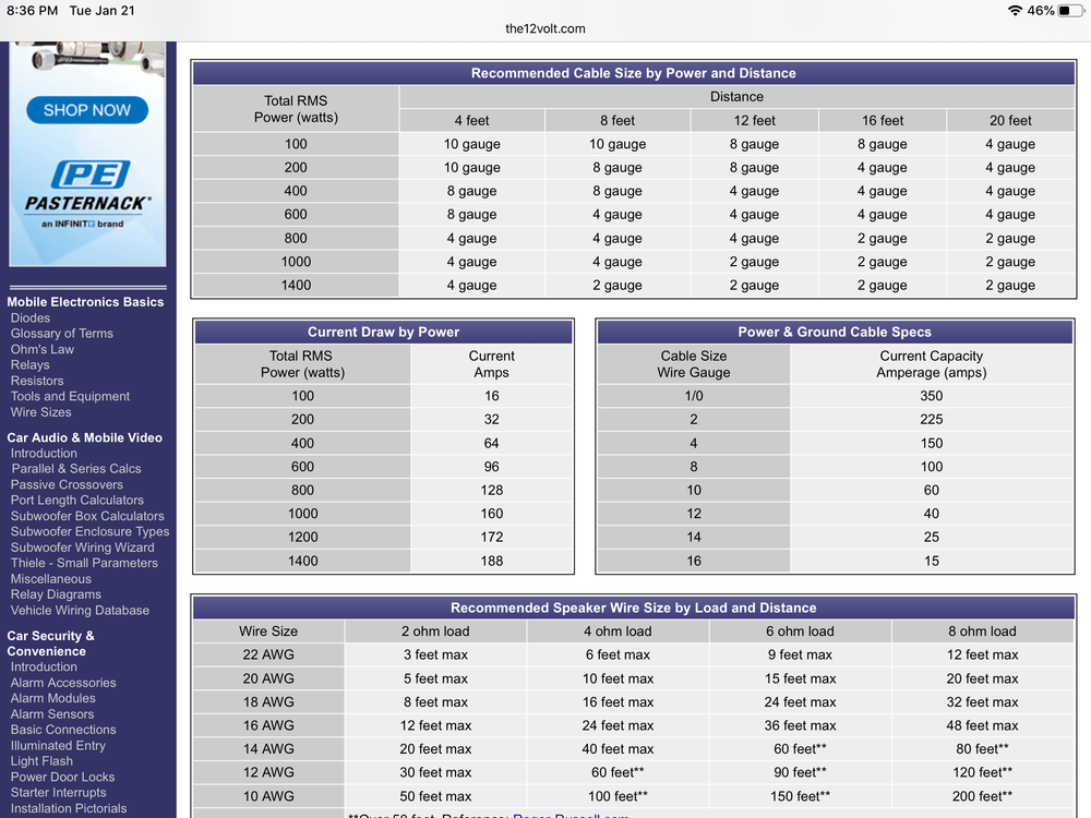

Start with an 80 you running amp at 2ohms or 1 ohm
You should be able to handle up to 150amps on 4 gauge but I’d limit it to 120amps , if it cannot handle that you need 1-0gauge
No way I'd use a 4g run from the battery to power an xtr 1500.1d.  those amps do way over rated power.
And you kind body hinted that you're feeding a second amp with this 4g.
You better feed that distro block a run of 1/0 from battery and get that big 3 done as well.
