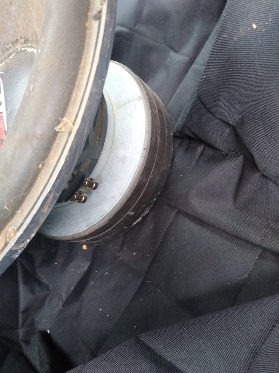

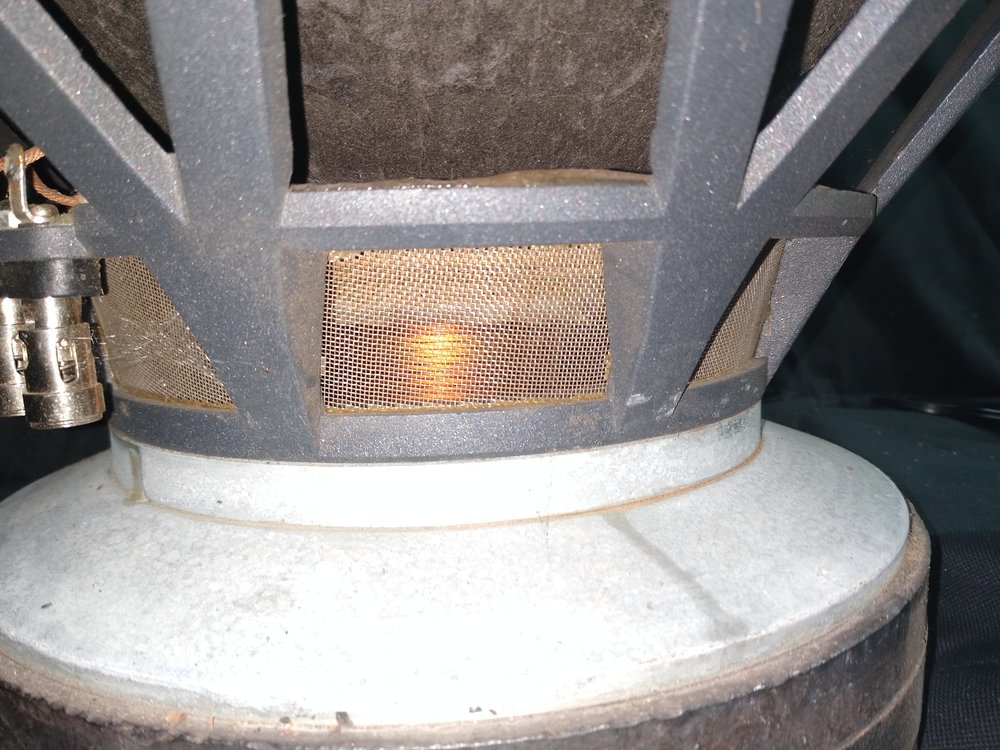

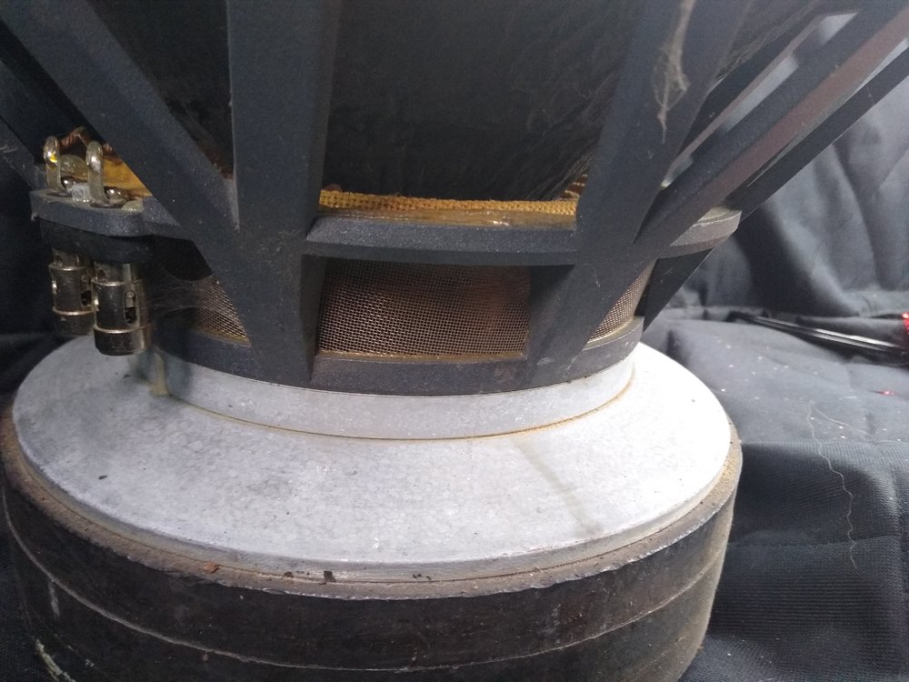

MichiganBumps Posted January 29, 2020 Report Posted January 29, 2020 Going to be building a box for it this weekend. And I am finding it difficult to find a box design. It's going into a Camry, so cant be to huge. What i came up with is front facing, side slot port, 44hz tuning is just a meh, dont wanna go down to 30 like i had before. (17 years ago lmao) Might go down to 36hz tho. https://subbox.pro/en/design/?bt=2&bw=650&bh=440&bv=80&mt=18&fp=1&sq=1&ss=15&cd=356&md=254&sv=2.8&so=0&sd=20&sb=&sn=&pt=3&pq=1&rf=44&pd=159.62&pw=3&pa=200&pp=0 Any ideas, thoughts, input? Tried to find some stuff on forums, but to no avail. some teaser pics. i know, she lookin rough right now lol 15" Neo Elite 135AH Lithium Bank Taramps Bass30k 320a Brand X Purple Metallic Ho Alt 125+ Ft of oversized 1/0
