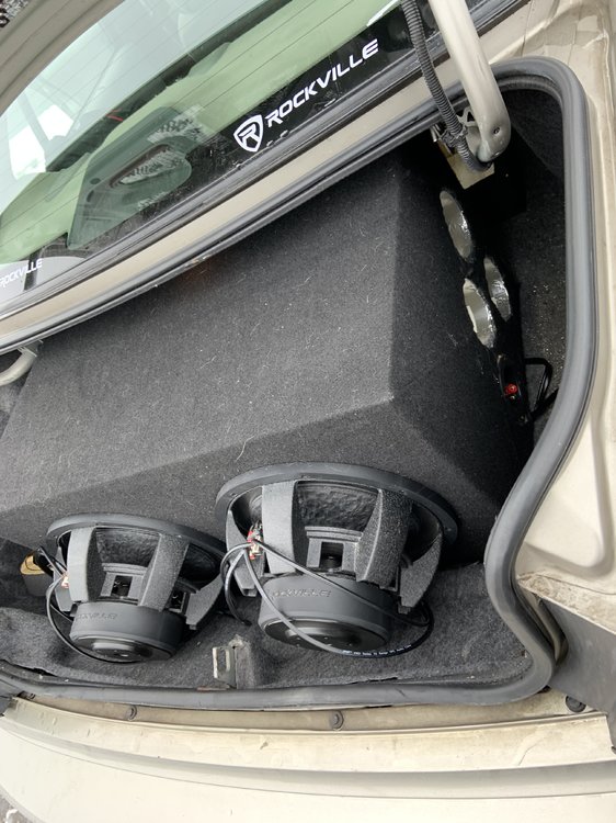

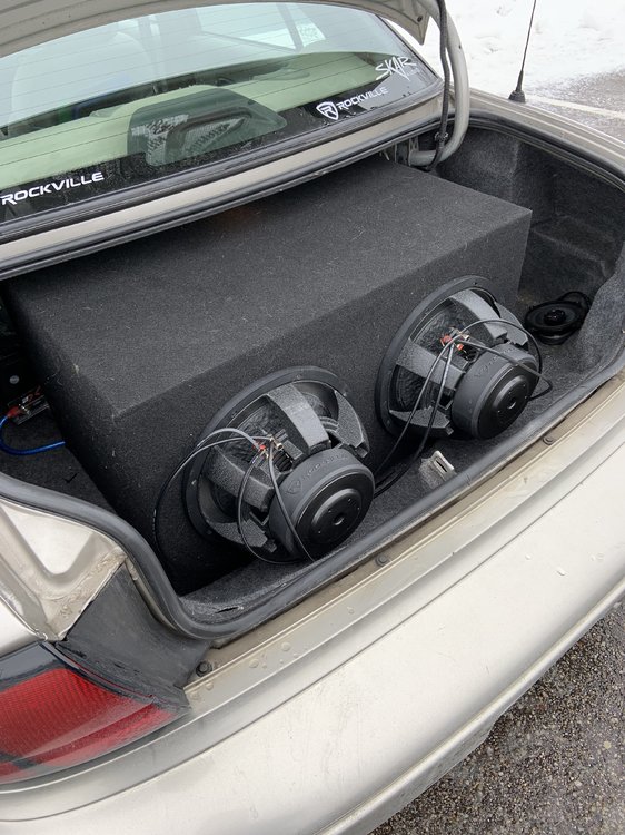

MrSkippyJ Posted February 10, 2020 Report Posted February 10, 2020 any chance you have a picture of the enclosure? F150: Stock 2019 Harley Road Glide: Amp: TM400Xad - 4 channel 400 watt Processor: DSR1 Fairing (Front) 6.5s -MMats PA601cx Lid (Rear) 6x9s - TMS69
Loslegend Posted February 10, 2020 Author Report Posted February 10, 2020 8 minutes ago, MrSkippyJ said: any chance you have a picture of the enclosure? Yeah when I go out to my car I’ll take a few pics and upload them for you,they are inverted so it will show my wiring as well,I accually pushed on them and found out that one is just stiffer than the other,what could that be?
Loslegend Posted February 10, 2020 Author Report Posted February 10, 2020 2 hours ago, Loslegend said: Yeah when I go out to my car I’ll take a few pics and upload them for you,they are inverted so it will show my wiring as well,I accually pushed on them and found out that one is just stiffer than the other,what could that be? Also is it possible my box is too big for these subs? I couldn’t find hardly any box specs for these subs..kind of shot in the dark with thus one
