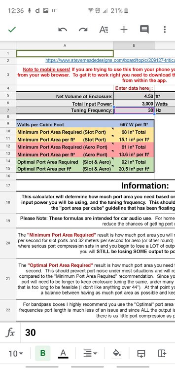

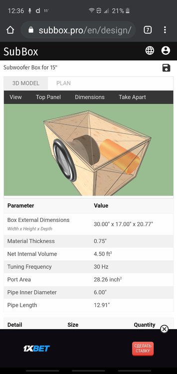

Colton37 Posted February 14, 2020 Report Posted February 14, 2020 I have an Xv2 15 on the way. I'm trying to figure out a box for my 08 cobalt. I dont have the exact dimensions possible for my vehicle yet but I can post when I get off work. I do know that 15 inches is the tallest I can fit through the trunk from inside the vehicle..(outside into the trunk is smaller) but the actually inside of the trunk is taller than 15. Just the metal lip behind the seats is 15 inches in height. So I could add a few baffles once the box is inside my vehicle closer to 18 or 19 to mount my sub. Or just put it half way together, slide it in then jus put it together the rest of the way inside Unless someone has a better idea.. Anyway when I use the port calculator I'm getting around 90 cu feet port area for an aero port on the calculator but when I go design the box on this website subbox.pro the port area they give me is way lower... like 28 sq ft port area.. please help
Mike4068 Posted February 14, 2020 Report Posted February 14, 2020 That software is basing port area on the 16 to 17 sq in per cube formula. Triticums calculator uses different parameters.
Colton37 Posted February 14, 2020 Author Report Posted February 14, 2020 22 minutes ago, Mike4068 said: That software is basing port area on the 16 to 17 sq in per cube formula. Triticums calculator uses different parameters. Thanks for your reply, Which one should I go off of?
bmwking Posted February 14, 2020 Report Posted February 14, 2020 1 hour ago, Colton37 said: Thanks for your reply, Which one should I go off of? triticums

shredder2 Posted February 15, 2020 Report Posted February 15, 2020 10 hours ago, Colton37 said: I have an Xv2 15 on the way. I'm trying to figure out a box for my 08 cobalt. I dont have the exact dimensions possible for my vehicle yet but I can post when I get off work. I do know that 15 inches is the tallest I can fit through the trunk from inside the vehicle..(outside into the trunk is smaller) but the actually inside of the trunk is taller than 15. Just the metal lip behind the seats is 15 inches in height. So I could add a few baffles once the box is inside my vehicle closer to 18 or 19 to mount my sub. Or just put it half way together, slide it in then jus put it together the rest of the way inside Unless someone has a better idea.. Anyway when I use the port calculator I'm getting around 90 cu feet port area for an aero port on the calculator but when I go design the box on this website subbox.pro 5 hours ago, bmwking said: triticums My .02... to me Triticums calc seems to be based on clamped power 1st off. A 5K amp on 2-12's... Figure rise and 81in2 of port (not 81ft3) for example should suffice in a 4.5ft3net /w/ 23-25mm excursion 1200w subs clamping 3K. Don't think if you got a 5K amp that automatically you'll see 5K. Voltage, impedance rise, thermal losses and other factors all determine your actual power I've heard... Just keep your velocities around 80-110fps when taxing your sub with a slot port and 120-130fps if possible with an aeroport (flared... not just a round). Volume/tuning affects velocities as well so watch excursion on estimated power while sizing the port. And watch how filters can affect everything along the way... my .02... 😉 Either way... Model those subs on your power. Calcs are fine but not super accurate. OP... a single 15" sub/6" aero?.... I'd sacrifice a touch of volume 1st before doing any other compromises, less volume means less port velocities usually and add filters and you'll probably be fine... model it up... lose a bit of depth and I'll bet that height you're working with will slide in there.

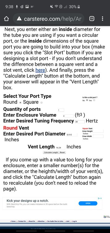

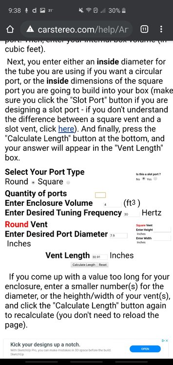

Oldmang Posted February 15, 2020 Report Posted February 15, 2020 A 6" aero would be better for a 12. I think an 8" or dual 6's would work well for that X. It IS a hi-excursion 1500w underrated sub after all.
Colton37 Posted February 17, 2020 Author Report Posted February 17, 2020 On 2/15/2020 at 12:34 PM, Oldmang said: A 6" aero would be better for a 12. I think an 8" or dual 6's would work well for that X. It IS a hi-excursion 1500w underrated sub after all. Well I tried to use a port calculator. If I use an 8 inch the length would have to put way longer than "big ass ports" make theirs. They only make them 21" but if I do a 6 inch tuned to 30 hz I can do it because their ports come apart. I've actually had many people say 8 in but it just wont work according to the calculators. Maybe If I wanted to tune higher than 30 hz a 8 inch port would work...
