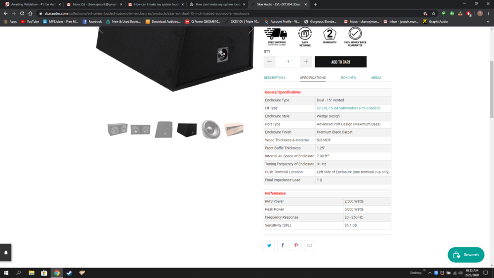

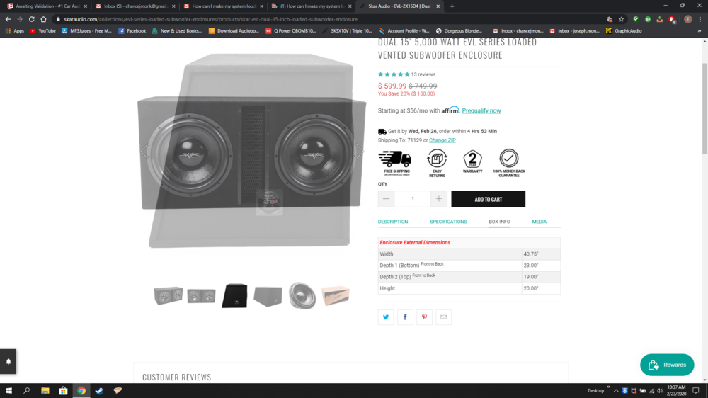

Skar'dSenesless Posted February 23, 2020 Report Posted February 23, 2020 I am running this system in attached pics with a Skar RP-3500.1d monoblock amp, Mechman alternator and a XS D3400 battery in 2015 Dodge Ram 1500 Quadcab. I currently have the box sitting on its back with the subs firing up towards the roof over the front seats. It sounds good, but I think it should be louder and rattling the walls and it isn't. Would a sealed box make it any better?
Joshdashef Posted February 23, 2020 Report Posted February 23, 2020 Usually ported boxes have higher output than sealed unless you are starving the subs with net volume or too little port for the power they are seeing. I'd say ditch the prefab and make your own tailored to your subs and tuning preference SMD Tool Map (2024): https://www.stevemeadedesigns.com/board/topic/226545-smd-tool-map-2024/ Great Box Bracing Examples: https://www.stevemeadedesigns.com/board/topic/202148-best-way-to-brace-a-box/?do=findComment&comment=3055002
SadrikX Posted May 20, 2020 Report Posted May 20, 2020 That is honestly a tough call, unless you have a few different boxes to try out you may be limited by the Cars inside cabin resonance. I have a custom ported box with a Skar 15 inch subwoofer that plays amazing in my Subaru Legacy (back seat) but that same exact sub sounds like crap in my Mustang. No matter which direction I face the speaker or ports. Really kind of bummed LOL I ended up finding a prefab ported box for my Mustang that actually sounded the best out of the many options I’ve tried. Even going with a sealed sub in the backseat or in the trunk was almost useless. Custom box is tuned to 28 Hz, another prefab was 37 Hz and this one is 33 Hz which was by far the best but it was quite a bit bigger than the 37 Hz prefab. Might just have to find the right tune for your cab.
1point21gigawatts Posted May 20, 2020 Report Posted May 20, 2020 Get a custom enclosure built a little bigger than specs with a port area a little bigger than specs with a frequency of 30hz and do subs up, port on the side, the drivers side. “How can we help you?” “And don’t forget to tell them that the customer isn’t always right.”
1point21gigawatts Posted May 20, 2020 Report Posted May 20, 2020 I just design an enclosure for a guy on here for his truck and he is running the same subwoofers. It was 8.07 cubic feet after displacements and 94.875 sq” of port area tuned to 30.5hz after displacements. Subs up port driver side. It’s gonna slam. “How can we help you?” “And don’t forget to tell them that the customer isn’t always right.”
