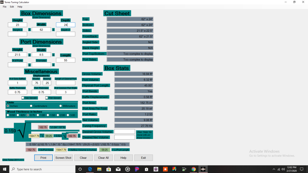

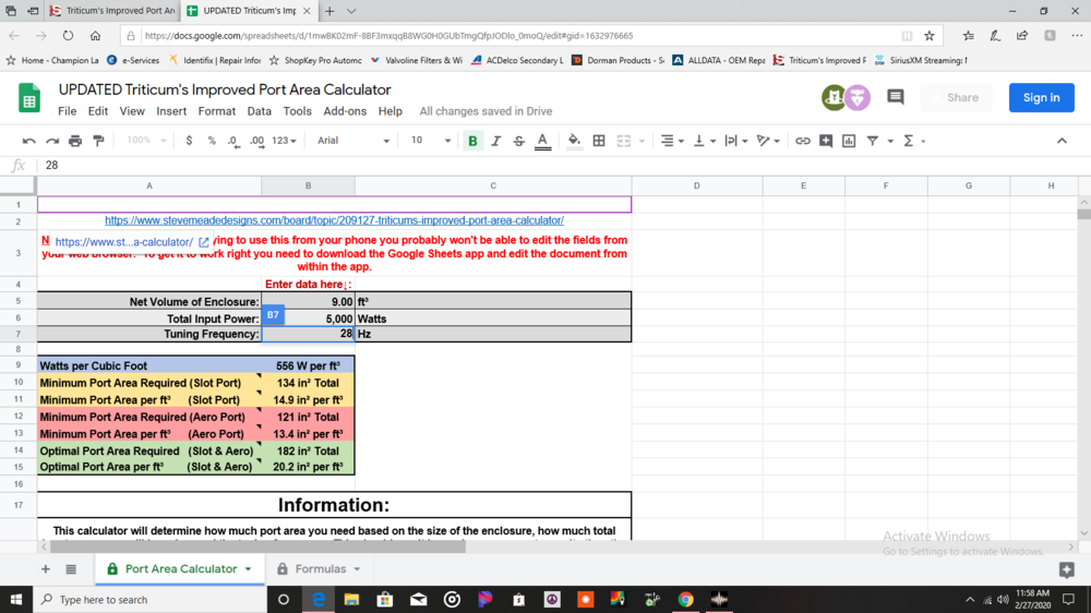

latest numbers, thimnk its gonna work out, got tuning down and got it to fit a lot better where I want it528103224_Screenshot(13).thumb.png.2d684ee978748511c162ba07153abf81.png2029755203_Screenshot(12).thumb.png.05ce11e6d30417391fbae256e66fff4b.png
