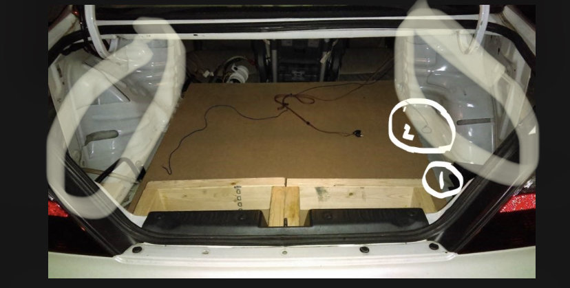

tomlintm Posted April 27, 2020 Author Report Posted April 27, 2020 here is a pic of the same car i had in the past that i started to build with with out carpet and that car seat is were the batter is placed
1point21gigawatts Posted April 28, 2020 Report Posted April 28, 2020 1 hour ago, tomlintm said: here is a pic of the same car i had in the past that i started to build with with out carpet and that car seat is were the batter is placed so right about there is where that carpet is where the ground is gonna go? “How can we help you?” “And don’t forget to tell them that the customer isn’t always right.”
tomlintm Posted April 28, 2020 Author Report Posted April 28, 2020 1 minute ago, 1point21gigawatts said: so right about there is where that carpet is where the ground is gonna go? that metel to the right the shape of a wheel and a strut connection
1point21gigawatts Posted April 28, 2020 Report Posted April 28, 2020 If so, then it’s gonna be hard to nut and bolt in that area. Not impossible though. Be difficult. If you want, the next best thing is to use 3 self drilling screws (1/2” to 1” long) with washers to secure the ground. One in the middle of the ring terminal with a washer and the other 2 on each side of the ring terminal so it’s tight and secure. “How can we help you?” “And don’t forget to tell them that the customer isn’t always right.”
1point21gigawatts Posted April 28, 2020 Report Posted April 28, 2020 3 minutes ago, tomlintm said: that metel to the right the shape of a wheel and a strut connection Well wherever the ground is going, just make sure you do what I just posted if you can’t find a way to nut and bolt it because of one side not being able to be accessed to complete the task. “How can we help you?” “And don’t forget to tell them that the customer isn’t always right.”
tomlintm Posted April 28, 2020 Author Report Posted April 28, 2020 circle 1 is were the wire is going down thru the floor and circle 2 there is a small lip there you think that will work
1point21gigawatts Posted April 28, 2020 Report Posted April 28, 2020 As long as you don’t ground it on that big piece of metal that’s welded on your chassis. See what I’m talking about? And plus you don’t need to spray that ground after grounding it because it’s in the car and not gonna be going through the outdoor elements. For some reason I thought that one picture and where you were gonna ground was somehow outside the interior of the car. “How can we help you?” “And don’t forget to tell them that the customer isn’t always right.”
1point21gigawatts Posted April 28, 2020 Report Posted April 28, 2020 Ground it right there on the ground where it’s the chassis. “How can we help you?” “And don’t forget to tell them that the customer isn’t always right.”

1point21gigawatts Posted April 28, 2020 Report Posted April 28, 2020 Right where you put the small black circle. Don’t ground it on that lip because that’s not the chassis, right beside it on the ground of the trunk is the chassis. Or just ground it in the original planned spot. As long as it’s the chassis (not metal welded or screwed or bolted to the chassis) and it’s close so the ground is short. That’s all that matters. “How can we help you?” “And don’t forget to tell them that the customer isn’t always right.”
