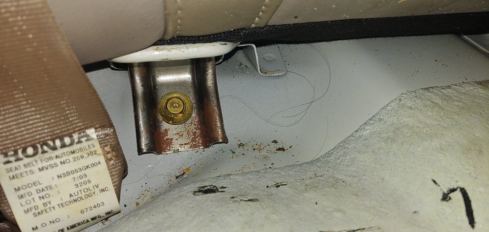

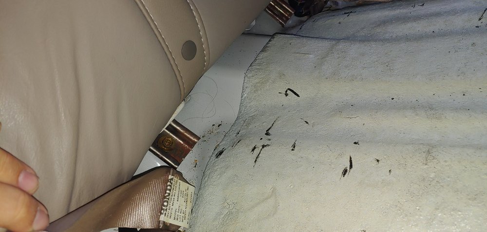

tomlintm Posted April 28, 2020 Author Report Posted April 28, 2020 u can see it in the pics i showed u my daughters carseat is on it
1point21gigawatts Posted April 28, 2020 Report Posted April 28, 2020 All I see is the back of the car seat. I need to see the grounding location to see if it’s chassis or metal welded on the chassis. It’s probably a good grounding spot but I can’t 100% determine that until I see the location, like the below the cushion on the metal where the ground is going to go. Show me. “How can we help you?” “And don’t forget to tell them that the customer isn’t always right.”
tomlintm Posted April 28, 2020 Author Report Posted April 28, 2020 right beside that braket that holds my seats to the body of the cardont mind the trash its from my daugher
1point21gigawatts Posted April 29, 2020 Report Posted April 29, 2020 That’s a good spot. Take that bolt off and move that strip of metal the bolt is holding down out of the way and then clean that area thoroughly and then when you put the ground wire there, put a washer on top of the ring terminal in between that piece of metal the bolts holding down and the ground wire ring terminal. “How can we help you?” “And don’t forget to tell them that the customer isn’t always right.”
tomlintm Posted April 29, 2020 Author Report Posted April 29, 2020 1 minute ago, 1point21gigawatts said: That’s a good spot. Take that bolt off and move that strip of metal the bolt is holding down out of the way and then clean that area thoroughly and then when you put the ground wire there, put a washer on top of the ring terminal in between that piece of metal the bolts holding down and the ground wire ring terminal. i was planing to creat a hole beside it so i dont have to touch that bolt b/c its a really pain in the ass to get in and out and on top of that the bolt is bigger then the ring termenal
1point21gigawatts Posted April 29, 2020 Report Posted April 29, 2020 17 minutes ago, tomlintm said: i was planing to creat a hole beside it so i dont have to touch that bolt b/c its a really pain in the ass to get in and out and on top of that the bolt is bigger then the ring termenal Do you have a drill and tap? “How can we help you?” “And don’t forget to tell them that the customer isn’t always right.”
tomlintm Posted April 29, 2020 Author Report Posted April 29, 2020 4 minutes ago, 1point21gigawatts said: Do you have a drill and tap? ya my friend has one that helps me with my car has one of thoes step bit and all i need is to get some sand paper to clean the metal off
1point21gigawatts Posted April 29, 2020 Report Posted April 29, 2020 6 minutes ago, tomlintm said: ya my friend has one that helps me with my car has one of thoes step bit and all i need is to get some sand paper to clean the metal off Then you’re ready to go dude. “How can we help you?” “And don’t forget to tell them that the customer isn’t always right.”
tomlintm Posted April 29, 2020 Author Report Posted April 29, 2020 idk if a foot will make it down that far tho bc that spot is right below were the battery is located
1point21gigawatts Posted April 29, 2020 Report Posted April 29, 2020 It probably won’t. But that’s a good ground spot. I would stay with that idea. Don’t change it up. It took a long time to get to this conclusion lol don’t go against it over spending like $15 to get more wire. Just buy more wire. “How can we help you?” “And don’t forget to tell them that the customer isn’t always right.”
