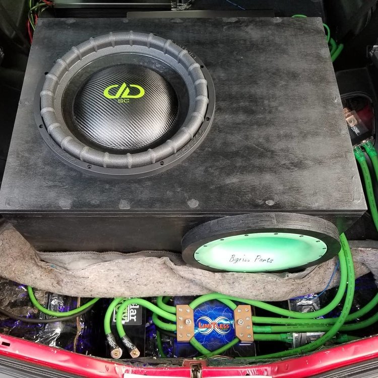

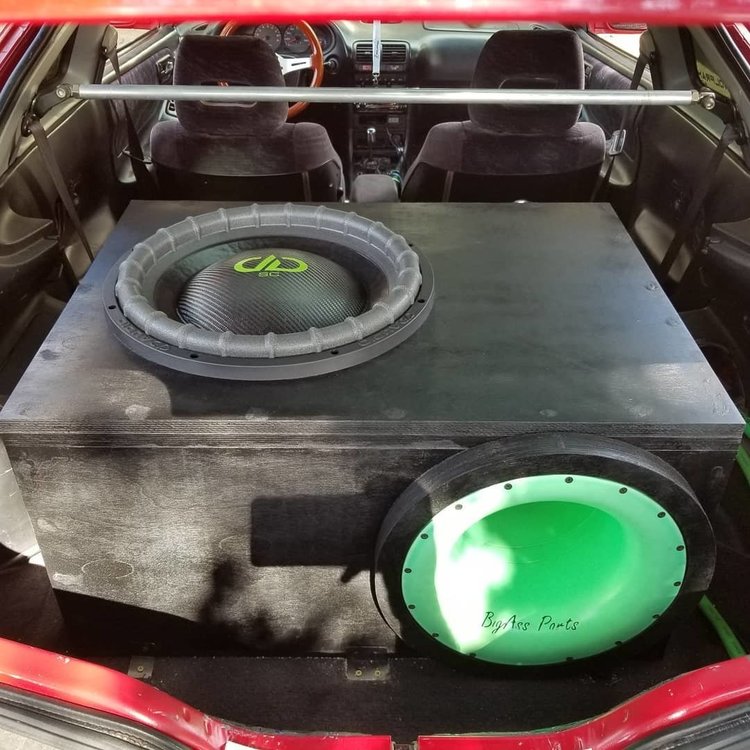

 6.5^3ft enclosure. Tuned to 33hz , that’s what I found online but not sure all your upgrades. That sub is a beast but needs a lot of electrical to run good. Wish I was in your shoes with that beast. I looked on DD Audio classified adds .

Of course i don't know exactly how much power those limithless can provide,the purpose of these pics was related to the style and shape of the box

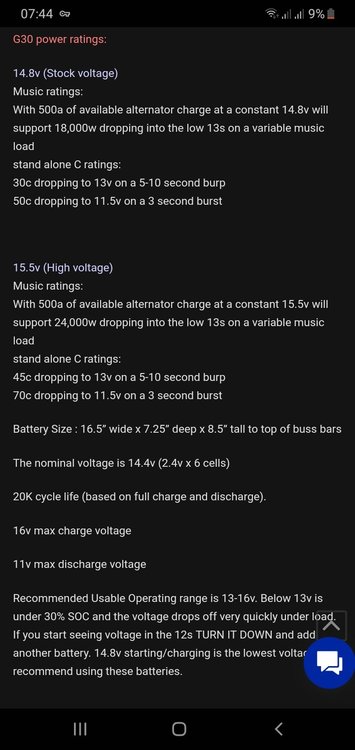

I've attached gorilla g30 limithless lithium battery

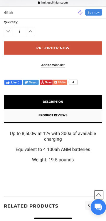

1 minute ago, 1point21gigawatts said:
A 45ah limitless lithium battery is equivalent to 400ah of agm batteries. That will support 8k as long as your alternator is 300 amps or bigger. Read about it on their website. I’m posting the link.
https://limitlesslithium.com/45ah/
Thank you
