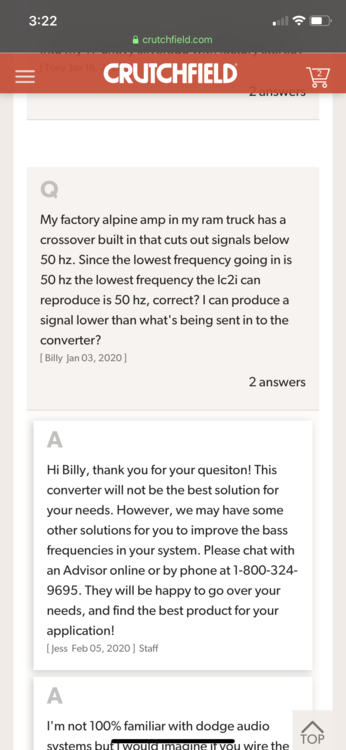

This in particular is what I’m referring to, it seems to be a problem in newer vehicles with factory amps, I could be wrong though.
In the original install in my Tsx with the original head unit I used an Audiocontrol  Lc2i to solve the bass roll off problem. It is the best solution without tapping into the the signal between the hu and the factory amp and will provide an amp turn on signal. Ultimately I did tap into the hu signal and upgraded to an Audiocontrol Three.2 to drive all my amps. Unless the crossover in your system is done through dsp, there will be a residual signal at lower frequencies that the Lc2i will boost.
