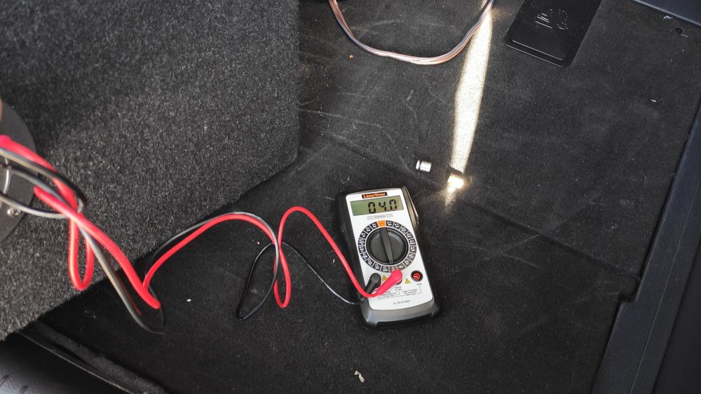

AaronT Posted May 20, 2020 Report Posted May 20, 2020 On 5/19/2020 at 6:04 PM, Joshdashef said: Just read through this post. Might have missed stuff so forgive me if I do... Do you mind sharing pics of your subwoofer box? Also disconnect the speaker wires from the box and use a multimeter to show the resistance (in ohms) of the subs. When you go to take a picture of the box leave it in the car to show where the port is and subwoofer in relation to the back hatch or seats. I own and use the 80 PRS in an active network mode, different than standard, but never had an issue with the crossover network. It handles everything from my HPF on my tweeter channels to bandpassing my mids and LPF my subs, (two amps. 4 channel has a channel per speaker/tweeter). For shits and giggles, do you mind sharing your crossover settings on the 80 PRS? Really the more we can see the better. It is so hard to diagnose a problem without actually being in person so the more we can observe the better! I really hope we can help you get back to cruising with some good tunes soon but we gotta find this problem first. Exactly this I want to see those speakers ohm out. The w3 is notorious for not getting much overrated wattage or any kind of abuse at all

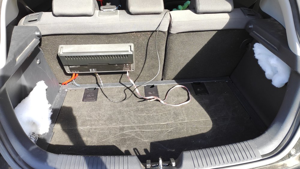

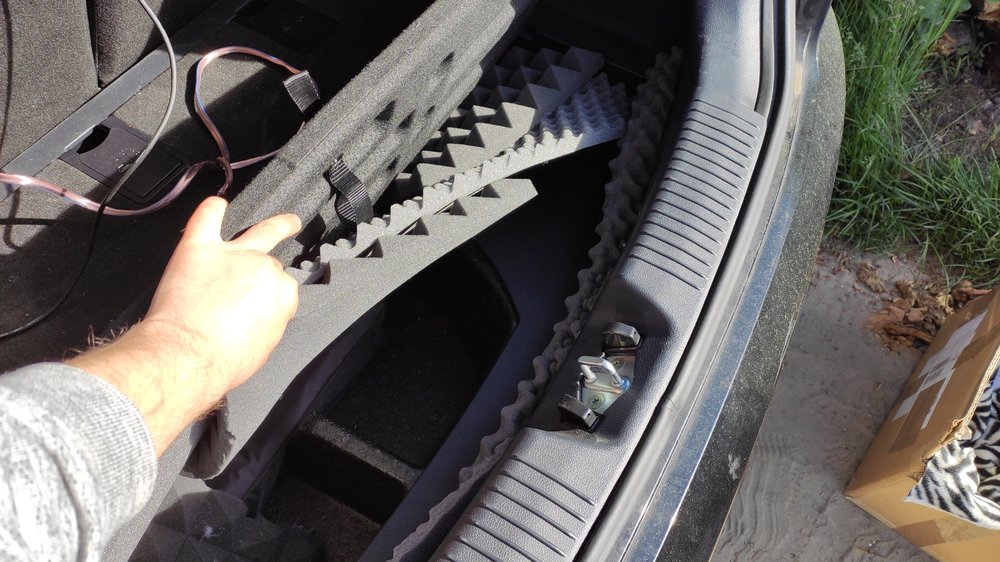

Qwiz Posted May 21, 2020 Author Report Posted May 21, 2020 I am going outside to the car right now to take some pics. So no one can explain why is my car not getting pressurized? I keep wondering this could be because of the trunks "physiology" having that HOLE for the spare tire. Here is a pic of the trunk, one of the Peugeot 206 my old car and this Kia Rio the new one. You cannot see for the Peugeot 206 when you lift the carpet in the trunk there is no hole for the spare wheel everything is metal flat.
AaronT Posted May 21, 2020 Report Posted May 21, 2020 You're not loosing pressure through the odd holes through out the car. I mean you are, but not to the degree you're thinking

AaronT Posted May 23, 2020 Report Posted May 23, 2020 It's 4ohm. It's hardly getting any power, that's the problem. You need something that's 600 watts capable at 4 ohm. Basically a 2400 watt monoblock.
AaronT Posted May 23, 2020 Report Posted May 23, 2020 After rise, that thing is maybe seeing 150 watts
Dafaseles Posted May 23, 2020 Report Posted May 23, 2020 56 minutes ago, AaronT said: It's 4ohm. It's hardly getting any power, that's the problem. You need something that's 600 watts capable at 4 ohm. Basically a 2400 watt monoblock. I just looked up that amp on the jl website. It says at 14.4 volts, at 4 ohm, 600 watts rms and at 12.5 volts it gets 500 watts at 4 ohm rms. I know that's just "what they say" and it's not always the absolute truth. I'm just saying. In my opinion, I think he's expecting too much from that sub. I think he said it was a w3 right? There's a reason that thing is only a little over $300 by a company that the next series up (w6) and their flagship (w7) are expensive as hell. I mean the w6 is $729 for a 600 watt rms sub.... that's just my 2 cents. It's supposed to be a bad ass amp though 2011 Chevy Silverado under construction My build log here. Check it out!
