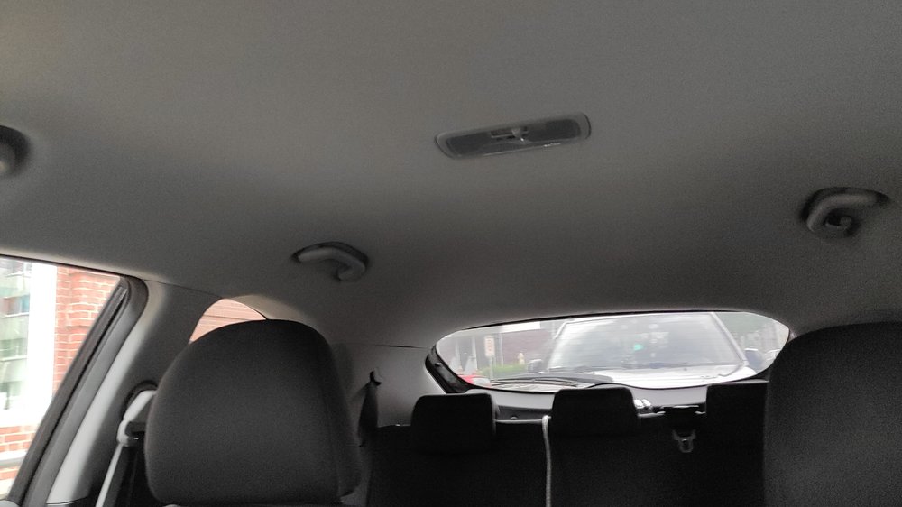

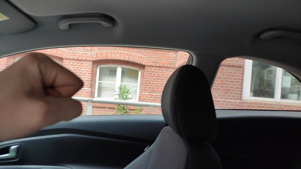

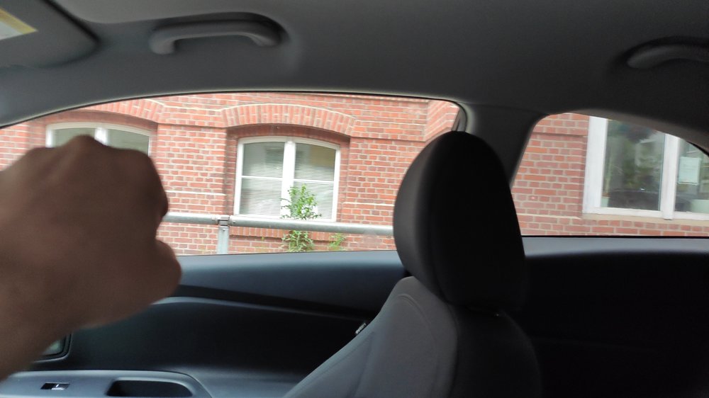

Qwiz Posted May 23, 2020 Author Report Posted May 23, 2020 I made another 2 pics to show you what happens depending on the head position. I made a brief video showing the interior of the car. I will edit this post to paste the links if you are still interested. Conclusion: On the day I was at the car audio shop we have tested a new box for my other sub, which the technician prepared beforehand, box built (or prefab bought seemed more like) according to ESX sub specs. Even with that new box it sounded same. I am doing a short recap only. Then we ve changed the amp - same. Then the HU -same. RCA cable - same. Another pair of twisted RCA bought by me, arrived today, swapped - same. Other useful conclusion: From the photos I will attatch I will try to explain the position of the head using my fist, you ll see. There is a huge output difference from the sub. For example for some particular subfreqs (test tone 55Hz), you face your head ahead and you hear this -muddy- bass at a certain volume. Then I move my head 90 degrees out of phase lol. So Imove my head in the perpendicular direction to the inititial position and guess what. The volume is much much lower and bass seems better. These tests were taken with the sub playing alone, everything else muted. Please try to do this in your car WITH A NORMAL SONG and TELL ME IF YOUR SUB PLAYS MUDDY ALONE, tell me if your sub alone plays the bass side of the song clean or does it "uuuuuuuuu" the whole time?. So that is one thing with the head direction. Some other subfreqs (30Hz - 42Hz) are OVEREMPHASIZED, bass overload. I have this "uuuuuuuu" sound, no matter if its a test tone or a song, with only the sub playing, as I said this "uuuuuuuu" sound coming from the sub is extremely bothering and when I set the 50Hz band to its max setting (-6db on the Graph EQ) it seems to TAME this "uuuuuuu" sound from the sub but then at the same time the whole song sounds crappy. Then again with testtones between 42Hz - 45Hz I have a variable dip, but a huge one, huge cancelation. Then from 45Hz to 55Hz overemphasized. From 56Hz to the crosspoint I again have an enormous dip like the sub plays but you hear it at a considerably low volume. I HAVE ALREADY TRIED changing PHASE on NORMAL or on REVERSE. THERE IS A SMALL DIFFERENCE, MEANING THAT on NORMAL sounds a LITTLE BETTER THAN on REVERSE, EITHER WAY THE MUDDINESS REMAINS no matter the PHASE MY DEAR FRIENDS. Sub plays this sweep 20Hz - 100hz just fine when you open the trunk and stand 2 feet outside next to it. Could it be that for this reason, this car Kia Rio is the worst car choice with the worst acoustics concerning a good in car audio experience? The sub seems to play clean while I am in the car, in this range of freqs only, 15Hz - 29Hz. Thats all I got lol. Feeling where the bass is coming from, from this 30Hz point up, feeling this muddy bass overload, life is good. Bass should have an embracing feeling and should always play omnidirectional so that you cannot realize where bass is coming from, you just have this awesome feeling that whatever the front system is playing, that output is being greatly empowered by the sub output. However as soon as you disable the sub output while a song is playing, you’re under the impression 3/4 of the song composition just died.Then when you enable the sub back, the song is immediately brought to life again, and you could just hear the sub alone and it would still sound good. God I miss that feeling. I will upload contents I hope you can bare with my frustration. I am still residing in the car right now. Have to get home to upload. Edit: Kia interior view https://www.youtube.com/watch?v=aIS2mvhaY80 Regarding pics, imagine that the hole in my fist is the listening ear.

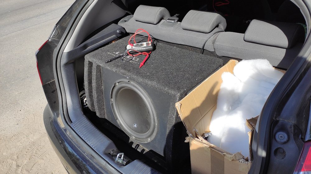

Joshdashef Posted May 23, 2020 Report Posted May 23, 2020 On 5/21/2020 at 9:20 AM, Qwiz said: You might be right. So I went ahead today and: Video 80PRS Old Settings on STANDARD MODE https://youtu.be/4NuHNJrgxGo Video 80PRS New Settings on NW MODE https://youtu.be/ph3qof4R-80 Below I will be attatching some etra pics as requested...... Funny question but how much clearance is between your sub box port and the back hatch? It should be atleast the width of your port or more. Try turning the sub box such that the port and sub are faced upwards (towards the roof). How does it sound? SMD Tool Map (2024): https://www.stevemeadedesigns.com/board/topic/226545-smd-tool-map-2024/ Great Box Bracing Examples: https://www.stevemeadedesigns.com/board/topic/202148-best-way-to-brace-a-box/?do=findComment&comment=3055002
Qwiz Posted May 24, 2020 Author Report Posted May 24, 2020 There is a video of the cars interior. There seems to be enough clearance. The box sounds the same when sub and port are facing up, tried that too. Take a look at the videos. And also what is up with the head position and the changing bass output? Is that the car acoustics causing this or the output of the bass being muddy? Also why is this output BEAMING? The front doors and the trunk are sound treated. So it might be the cars acoustics but also I am suspecting the box. Because the sound coming from that port is very muddy. It's not muddy when you listen to it from the outside of the car at a fair distance. I don't think bass should be that muddy straight from the port though because that is what I am hearing in the whole car regardless of any setting. Crap
