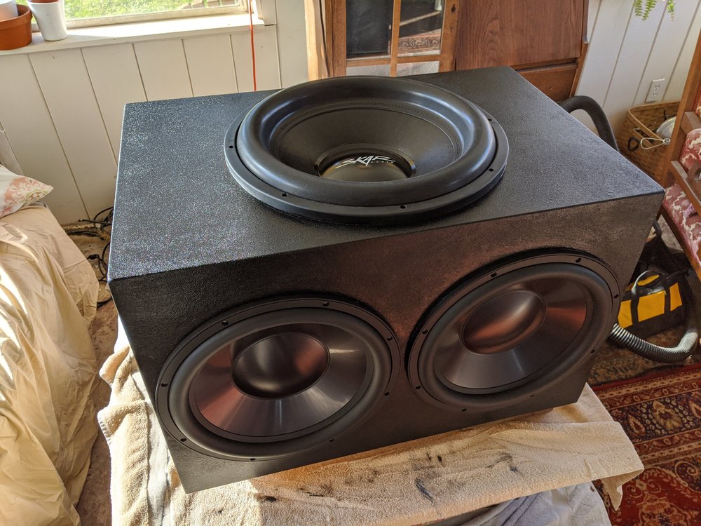

Actually, when designing my enclosure, I included sub displacement, braces... silicone... Everything ! :) lol I'm telling you, I'm SO freaking anal about this stuff. Id bet my truck, that this box is within .1... or maybe .05 cu feet, of 5.0 "net". And keep in mind, adjusting my tuning frequency is as easy as removing a 75 gram weighted washer from each of my Passive Radiators (they have two each, right now) and replacing it with a 25 gr washer, which I can do without even removing the PR, while I have the 18" subwoofer out for replacement.  All of this stuff is really easy to model in WinIsd too. I play with this stuff for hours, just for fun :)

Well I'm not using an actual port. My passive radiators act as a port. Dropping the counter balance weight from the current 150 gm's per PR, to 100 gm's is what will bring it back up from 29 to 32hz
I didn’t read that post before that picture post thoroughly. Luckily I’m good at reading pictures lol! I didn’t know you were using passive radiators as a port. I wouldn’t use PRs for a SPL application though. It also reduces xmax and doesn’t move as much air as a regular bass reflex enclosure. But it works though. Fugh it. Its kinda cool because not many people are using PRs.

Ya know, it's interesting. WinIsd does show about 1 1/2 db loss... But This is just the nicest sounding box I've ever built. Super flat response. Plays deep bass really well, but also such tight, snappy kick drums. I swear I could cross thing over at 200 hz no problem, but then my four 8" mid bass drivers wouldn't have anything to do 😀
