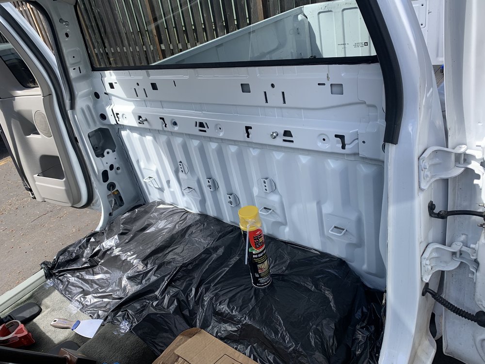

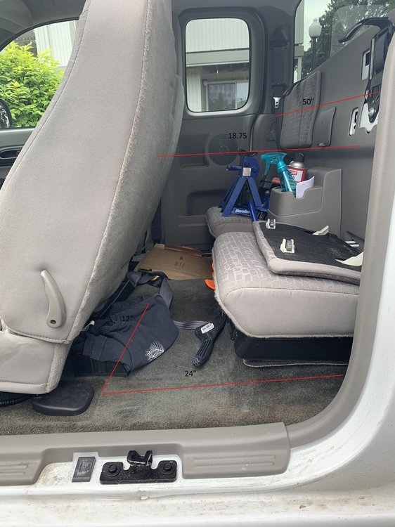

This is what I’m working with roughly with panels and seat where I need it to drive
This is with out panels but I’d like to try and keep them at least the pillars not so much the back below the window if the box will hide it
