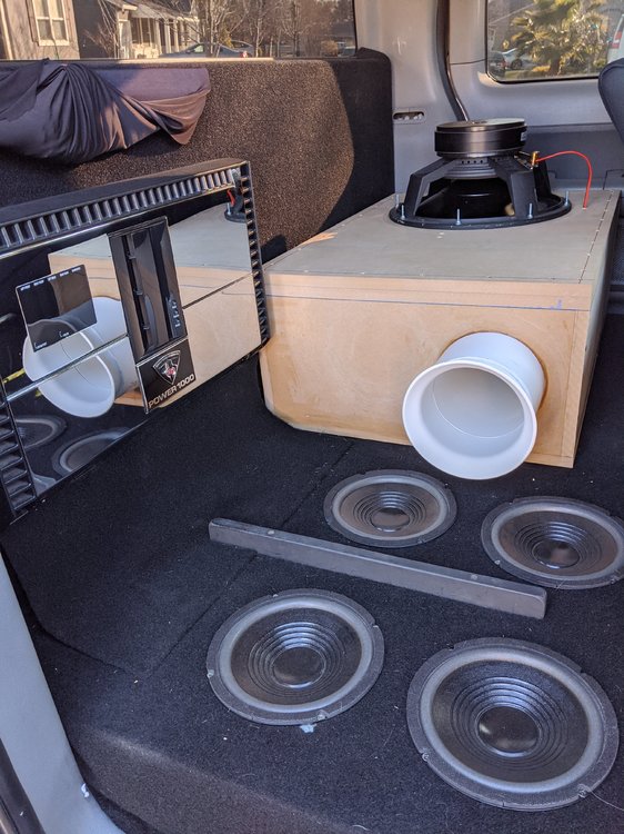

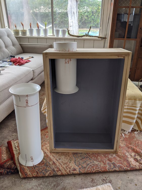

You can also make your own flared ports. I made these with 6" riser tube, then heated the edge with a heat gun. Then forced it down over a bowling ball 🙂
