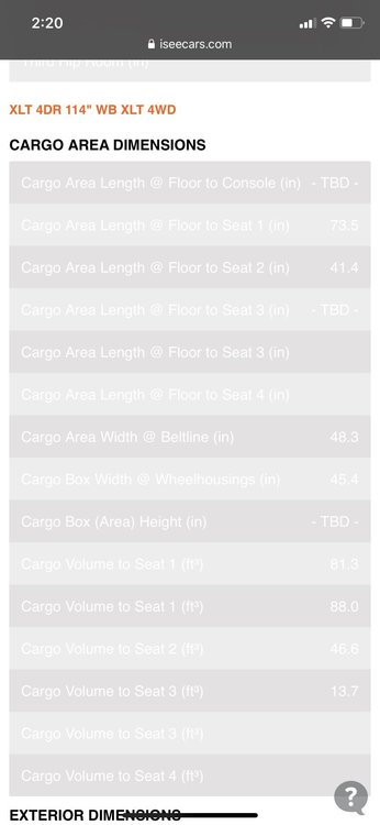

Send me measurements of his cargo area, width and depth.
He is at his Moms now but here is cargo dimensions I found online.
8 minutes ago, d luv said:
Ok I’m sorry to keep being a pain in the ass. If you had to recommend a box build while trying to conserve cargo space what would you suggest?
My bad. I didn’t mean to be a smart ass or condescending. You’re fine. I’m just irritated. It isn’t you, nor this thread or anybody on it. I do apologize though. Let me google the cargo measurements and I’ll design you an enclosure that will make him happy. I will stick to recommended specifications. Nothing crazy.
