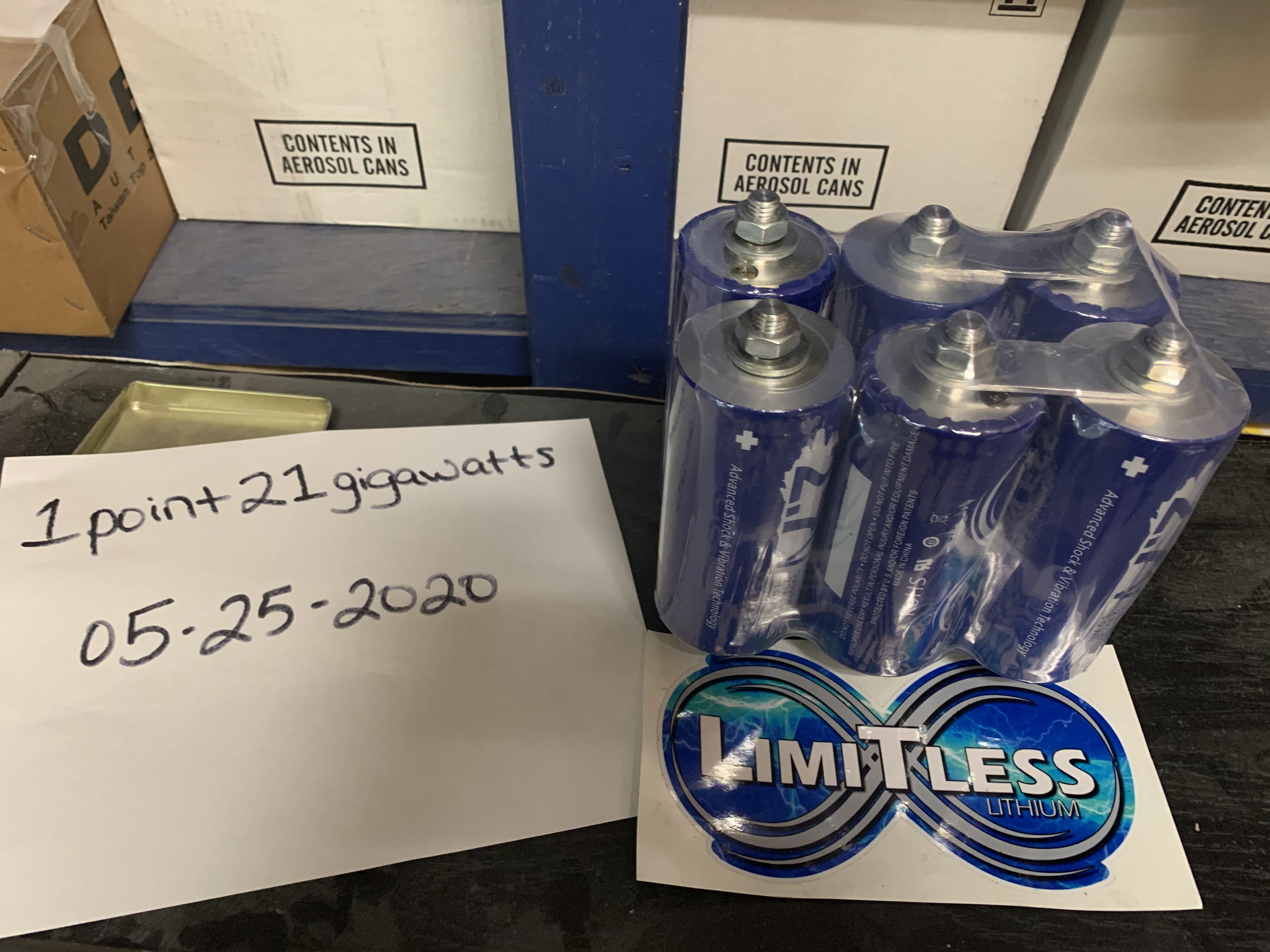

Yep. The closest to the amp a bank of caps is, the better. I don’t see why you don’t just delete the front battery and run the lithium and caps in the rear. And don’t spend $500+ on a bank of caps that just has a case around it. Pay $299 for a bank of 6 capacitors. It’s the same thing, you’re just not paying over $200 for a case around the caps and some terminals. That’s crazy. Just buy the exact same thing that’s inside it. Here’s the post.
https://limitlesslithium.com/limitless-super-caps-2-7v-3000f-bank-of-6/
:guido:
Right now most of the limitless lithium products are on back order. But I have a bank of caps that I bought 3 weeks ago and never used and I already talked to them Friday and I was planning on returning them tomorrow. Let me know and I can sell to you instead. Same price. $299. I’m only returning them because I’m gonna be running 80ah of lithium instead and on the set up I’m doing, I’m most likely not gonna drop below 14, ever. So I don’t need caps. And I need the money so I can buy this expensive ass lithium I want.
