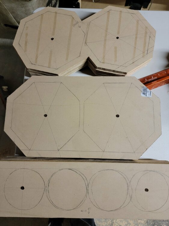

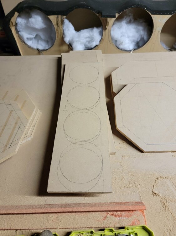

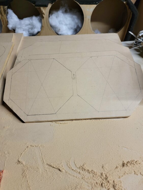

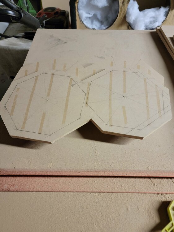

So, a little more progress this weekend. Didn't get to work on it quite as much as I would have liked. The wife and I took the girls to the beach. My oldest had never been to a beach, and she'd been asking to go since she saw it on Mickey Mouse Clubhouse or something like that. It was fun. Worth it. Ok, back to business.
I got all the templates I need (hopefully).
These are for the 2 8's that are going to go in the front of the door, behind the glove box (when it's open) and around the handle. 20210829_213540.thumb.jpg.8b090f09709c61756c7d74f7b15997c9.jpgthese are for the rear two 8's that will sit low on the door, next to the seat. 20210829_213547.thumb.jpg.f21fdff106846350d19f90cbf58383bd.jpgand these are for the 4 tweeters that will sit under the arm rest (unless I find a better place for them) 20210829_213544.thumb.jpg.33f8be979fe5b624ef0f1d9ec4b18dc3.jpgSo, next I stacked them all up as close as I could get them and put 2 screws into the center of where the speakers will go to hold them in place20210829_221428.thumb.jpg.fd36bbc0ae5ab2082399ca911d82d4bd.jpgThen getting down to a shit ton of sanding to make them all equal and pretty20210829_223209.thumb.jpg.9cc7e81ad5658562b8329d92eeb55baa.jpgI didn't get too far along in the sanding. It's about 11 o'clock Sunday night and my old ass needs to get to work tomorrow.
