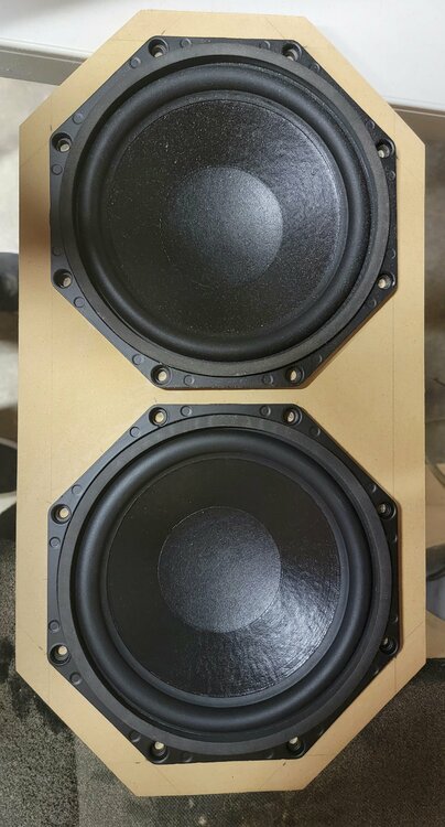

Dafaseles Posted September 8, 2021 Author Report Posted September 8, 2021 How's this look for one of the 8" baffles? 2011 Chevy Silverado under construction My build log here. Check it out!
Arthur79 Posted September 8, 2021 Report Posted September 8, 2021 20 minutes ago, Dafaseles said: How's this look for one of the 8" baffles? I think it looks awesome! I love the basket design of the 8s and how you continued the design language of the speakers into the baffle. This is going to be epic brother!
