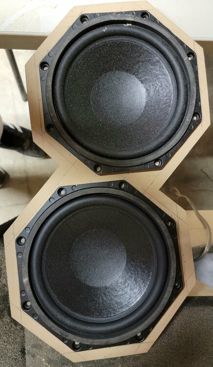

I think it looks awesome!  I love the basket design of the 8s and how you continued the design language of the speakers into the baffle.  This is going to be epic brother!
Thanks. Yeah, the octagon shape actually made it a lot easier to deal with in the baffles. I can't cut a circle lol. But I can cut straight lines lol. It cuts down on a lot of material as well. Hopefully making it lighter for my door hinges.
It's hard to see with them laying flat like this, but these will be staggered around my door handle
Looking good!  I can't wait until you get to the mockup stage!
Next I need a router. I've got the speaker grill material on its way along with the magnets. Get that done, then paint. Then I can start mock-up. I really want to jump ahead of myself and start cutting shit up and mounted, but I have to keep telling myself to keep taking it slow. It'll be worth it.

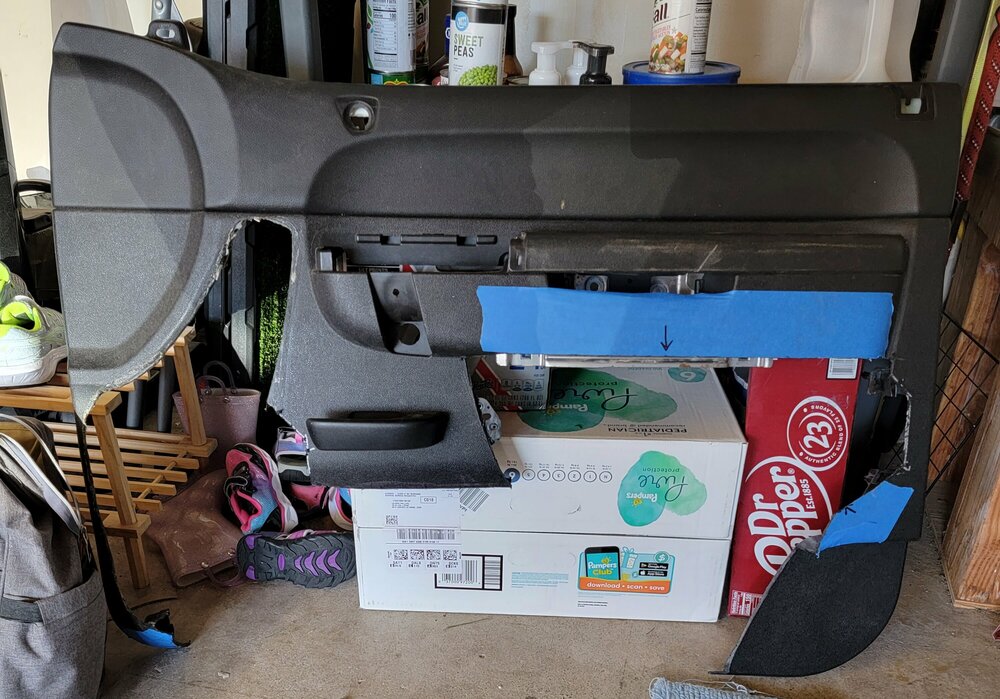

My cousin came over and we jacked up some stuff. Came up with a few doesn't ideas.... and that's exactly why I asked him to help! Instead of using magnets to mount the speaker grills, we're actually going to use plastic grommets and posts, like home speakers. I liked that idea a lot more. I have to order them though. We kind of fitted the baffles in the door with the cut door panel, and it should work. I'll keep plugging along

Definitely no turning back, but also exciting and cool as hell!  Love the idea of using the grommet mounting for the grills, probably way less chance for the grills to rattle when you've got it turned up.

My cousin also had an idea about mounting the wood to the door frame. We removed/ cut all the plastic clips and plugs off the section of the door that we're going to get rid of. He said liquid nails would adhere them to the wood, and they'd never come off. Worth a try I guess.
Next time he can come by is the second weekend of next month. He's going to bring the table saw. He thinks it will make mocking up the frame mount for the doors a breeze. I'm not one to argue making anything easier lol.
Also, I noticed last night while I was working on some stuff, that my original plan of using a half inch piece of MDF cut into a ring with the speaker grill wrapped around it wasn't going to work. I mounted one of the 8's, and looked a little closer, and it wasn't even close to being able to go over the top of the 8. So I had to glue 2 pieces together in order to make it work20210919_201132.thumb.jpg.c22ea8bec7863d9bb336d8f0350247ed.jpgalso, my plan was to only have the rings be a half inch all the way around. The new idea is, since I'm not going to router a channel around it for the ring to sit inside, I'm just going to cut out holes where the speakers will sit, leaving the most amount of wood I can. It shouldn't add a lot of weight to it, but it will make things a lot stronger.
