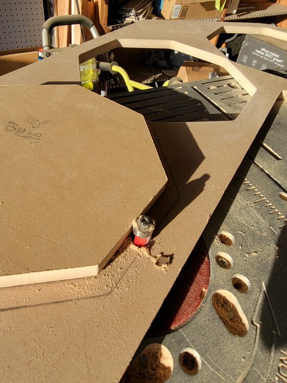

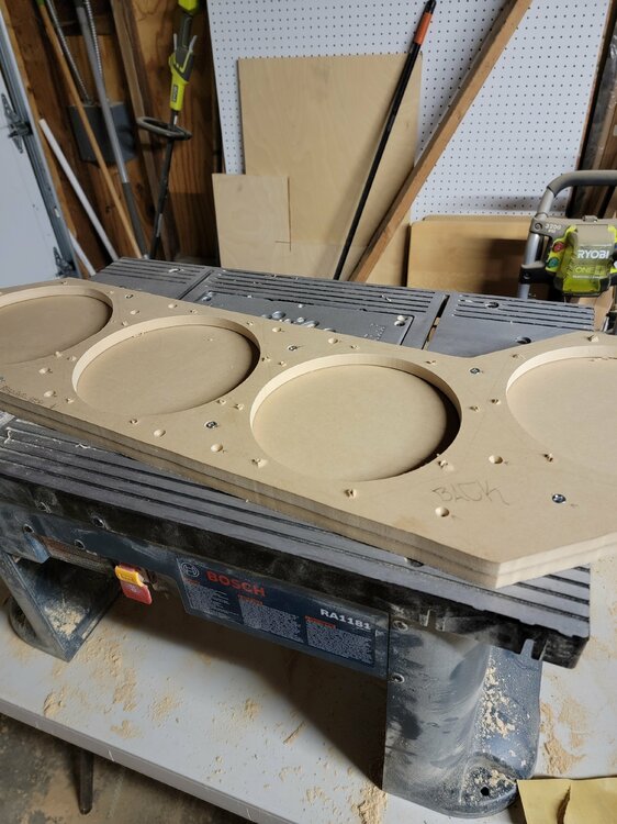

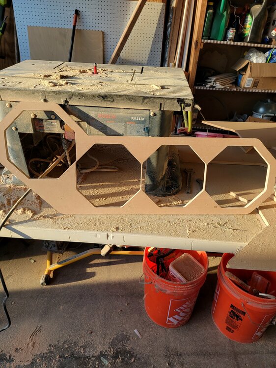

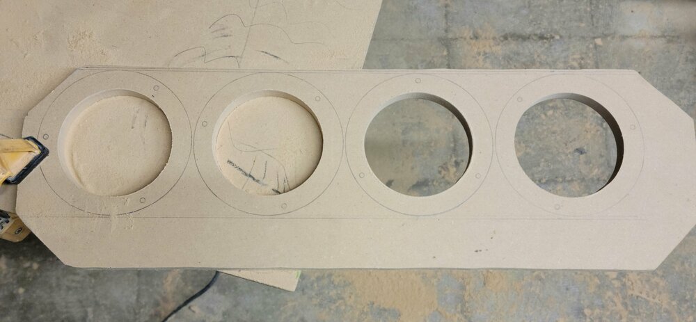

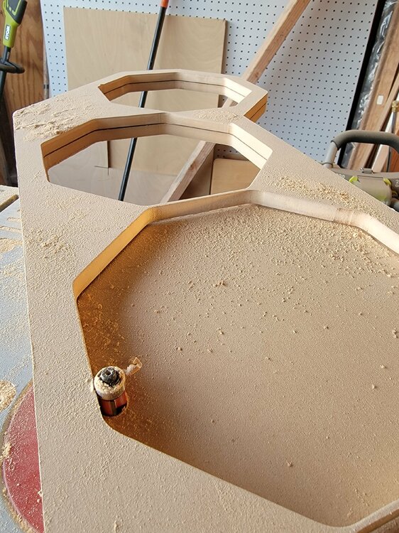

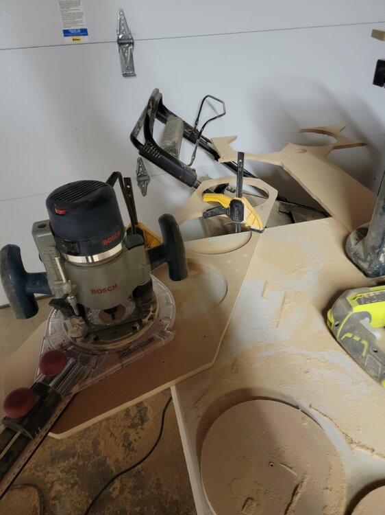

Today, I cut the holes for the top pieces. The pieces that will "flush mount" the 8's.
Basically, I took that template, and used template tape to tape it in place. Then I used my flush trim bit to cut the holes out. 20211211_152839.thumb.jpg.c3e6a11f78118dbc1a61d6aeb038ab07.jpg

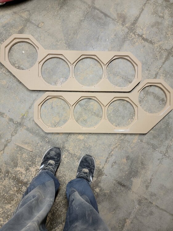

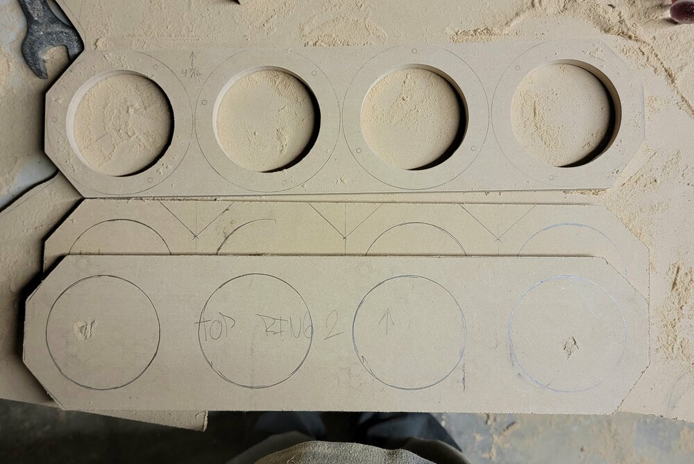

Then I used the template tape to tape the done piece to the second top piece and cut out the holes to be in the same place. 20211211_162038.thumb.jpg.570bda71888eb052afefbe82e60a04f3.jpg
Mirror images damn near20211211_164334.thumb.jpg.9799a1b2dc0b885c890bedb394012de8.jpg
ROUTER FOR THE WIN!

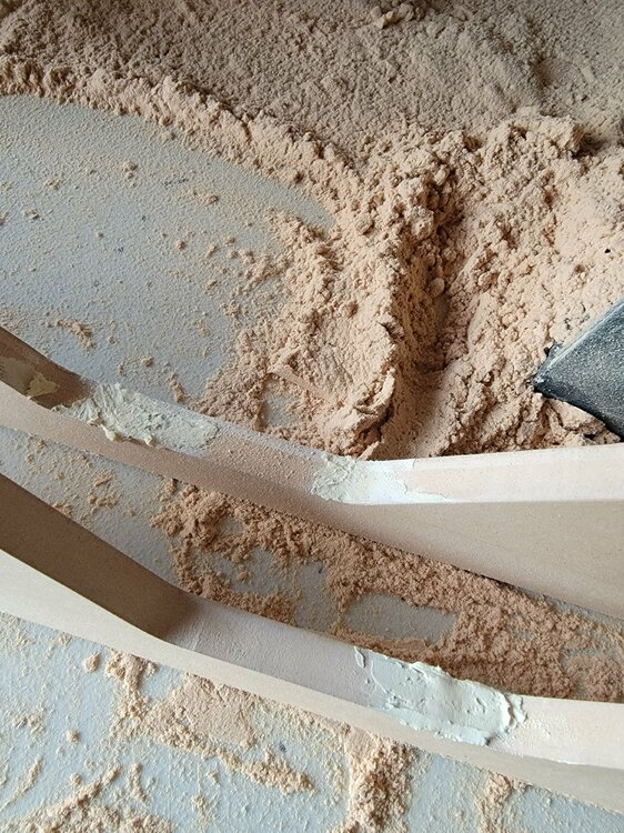

Then I had to use some wood filler for some grooves I messed up and made. No biggie. Once it dries, I'll and it flat. 20211211_165045.thumb.jpg.45281b2fcde9e121b8400ec1727b3338.jpg

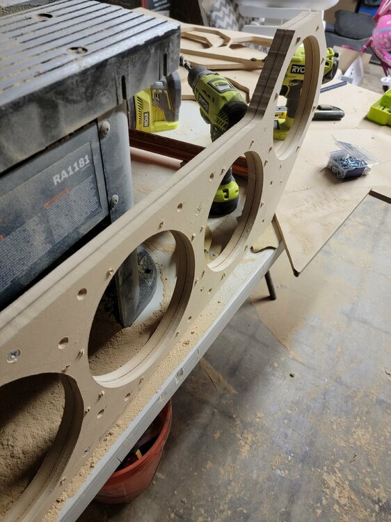

Here's a picture after I fit the back piece onto the front piece. 20211220_143217.thumb.jpg.918e554694513e3759f15a8098d205be.jpg
I wish I got pictures of how I went about doing this, but I had my doubts it was going to work, so I was pre bummed I guess lol.

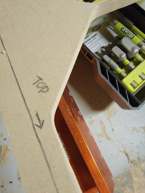

Anyway, since both to piece are the same, I traced the speaker holes onto the back piece, flipped it over, then fit that into the top piece for the opposite door, so I had the layout facing me. That helped me plan where the screws would go.

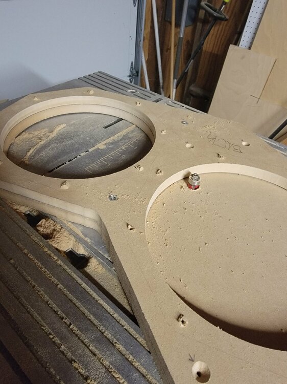

Only problem, I didn't leave enough space in some places for screws, including both ends. 20211221_233216.thumb.jpg.aa5213dfbecb58473f88fc841c25c5c6.jpg
If I tried to put a screw between the line, and the speaker hole (where the arrow is), there no way I wouldn't split the wood. So I'm going to get some JB weld or some super duper glue, glue those areas, and hope for the best.

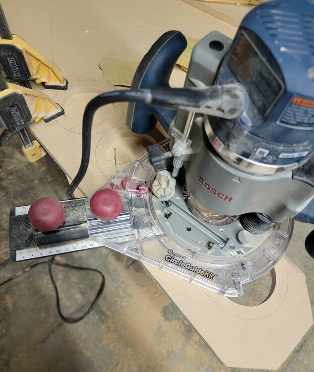

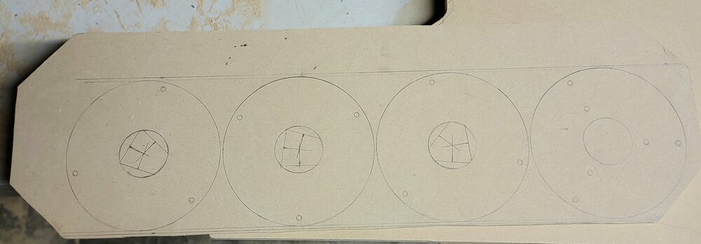

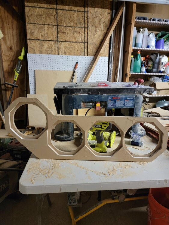

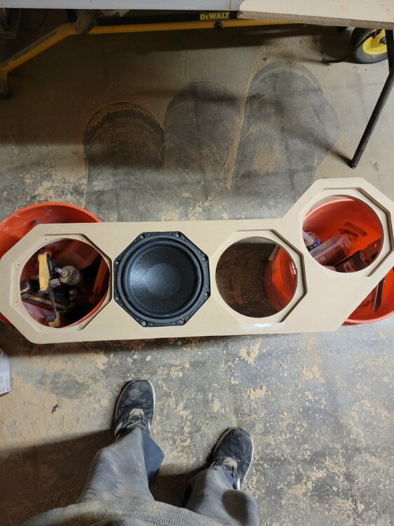

So I found the middle of the speaker holes and got out the circle big for the router. 20211221_230611.thumb.jpg.023bbd5997542463ce360acc26f4e529.jpg
This was nerve racking because I only have a 16th of an inch to play with for the speaker holes. If the mounting holes where too off, it's junk. Start over.... again. But couldn't stop. Had to keep going and be confident I was right. And I was! 20211221_231546.thumb.jpg.a8c99af45799350abe1b9acbb9d0893d.jpg

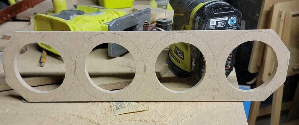

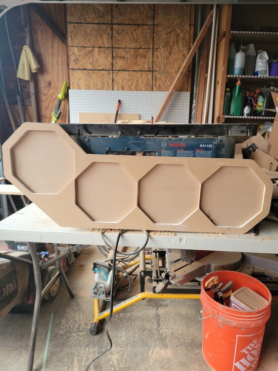

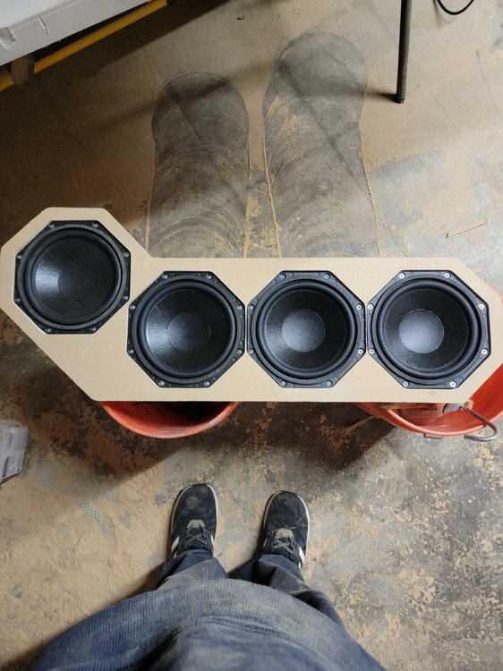

Here, you can see the final top and bottom married.

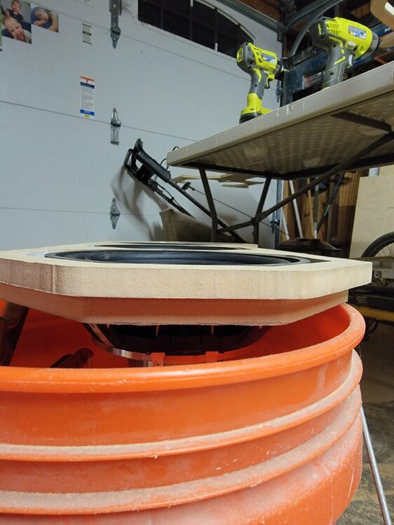

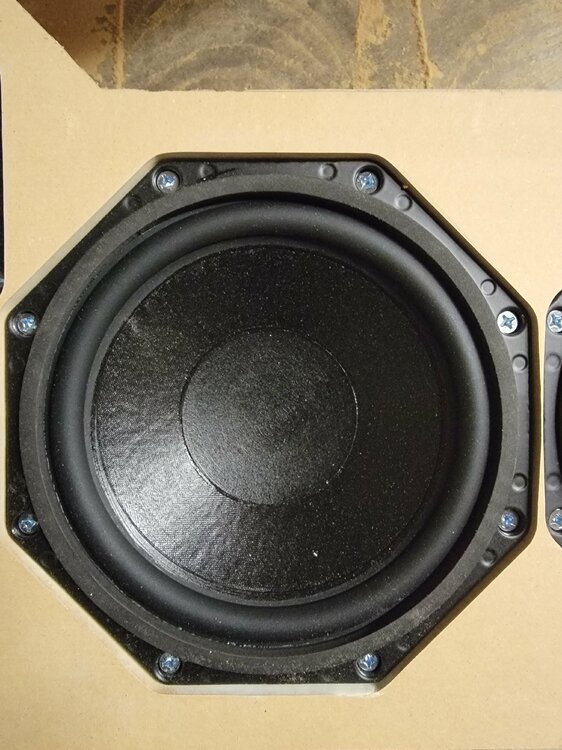

I tell you what...I couldn't wait. I dry fitted every hole with a single speaker to make sure everything lined up. It did. I had to see 4 8's in this thing at once for no other reason, I was happy! I hope you enjoy it as much as I did! I'm still looking at it lol. 20211221_233818.thumb.jpg.34888d461c3e0fdf2536fd3609c8c690.jpg
and they sit nice and flush! 20211221_233831.thumb.jpg.dd0eefc753c411ee02ffc2b17504ca87.jpg
Looks good nice and close too 20211221_235406.thumb.jpg.8a304e35215a5cf8d926af8a8d0f5396.jpg

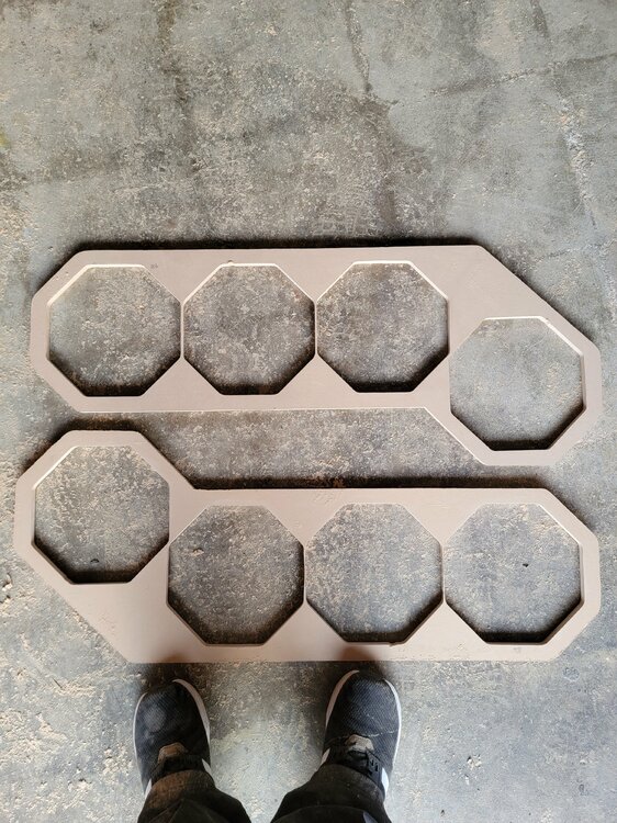

Then went ahead and did the drivers side. To say this side was easier than the passenger side would be an understatement.

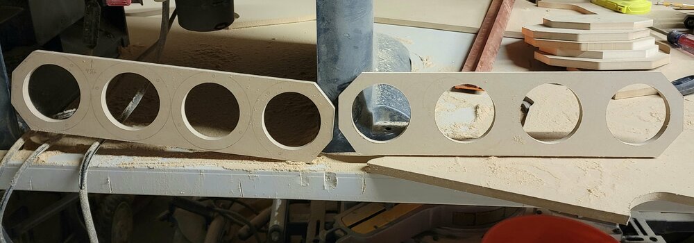

I started by lining up the 2 back piece and mirroring the drill holes for the screws. Then screwing them together20211222_005234.thumb.jpg.fcfbc8f08eb47377c0fbb429e0dadae5.jpg
Next, I drilled some holes, got out the old flush trim bit and went to work20211222_010218.thumb.jpg.6f7118ec1c33285c6bb3d68514775931.jpg
Made a mirror image damn near20211222_011514.thumb.jpg.8d8fefbaf027a0be17f4f1fda5cd49ee.jpg
So then, the real question, when I marry this backing to its front... will the speaker mount holes line up with the speaker holes in the top piece? 20211222_013511.thumb.jpg.2f9a3a2a99bdc21a8a4603fcfb8e2e0b.jpg
Muthaphukin success! (I did check every hole with the speaker lol) 20211222_013952.thumb.jpg.6812f9a9bb1cd3bbbed7157b665b1928.jpg

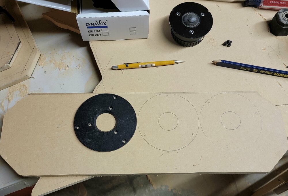

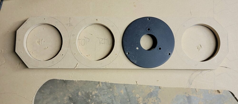

Started by taking the mounting plate off my tweeter, and using that as a template to draw the placement on the baffle. 20211226_222942.thumb.jpg.6e8b9988999cb5caa5bec6dba5130069.jpg
The hole in the middle is where the tweeter dome is. So next I found the center of that circle.20211226_230044.thumb.jpg.9531b108f28c698ee768277181463fd6.jpg
I used that as the center point for cutting the mounting hole in the baffle. 20211226_234427.thumb.jpg.617a71da1702185f9df17bb41551e086.jpg
All the holes ended up being very uniform and exactly the same size. Router for the win again! 20211226_234740.thumb.jpg.adcdef0bce70e953f47b33cd26c539f4.jpg

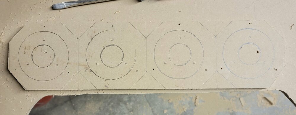

Then I made 2 more identical solid pieces that I will cut into the mount for the grill for the tweeters.20211230_234449.thumb.jpg.7453359bbe6b7655fbd64cf8979b59c7.jpg I had to start by figuring out exactly where the tweeters will sit. So I took the mounting piece of the tweeter again to drill some holes and trace everything into the solid pieces20211231_000234.thumb.jpg.51f038c7712ed0d98190875c1c33ecf9.jpg
With that done20211231_002809.thumb.jpg.09bed432dc2cf42a2da1688ac0b6647b.jpg
