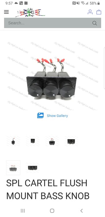

Dafaseles Posted December 26, 2020 Author Report Posted December 26, 2020 I was thinking of moving the VIV components into the rear doors (2 6.5's and 2 1" tweeters per door, passive crossover) off another JX400.4 I've got. It's not going to be super loud. Basically they're there for when I turn my bass and my front doors down and my daughter's are in the backseat. My 4 year old loves music, so I just wanted to make sure she had something back there so she could hear it. I was also thinking of getting 3 flush mount "bass knobs", but using them for the highs amps (unless I'm completely wrong and that's not going to work). I want to go nuts, or no ones in the backseat, turn down the rear amp. It's an underground hip-hop song that's mixed really soft, give the fronts full power. Slayer comes on, turn down the fronts so my eardrums don't bleed. My daughter's are in the truck, turn everything down to a moderate level. The Three.2 already has a bass knob controller, so I've already got that covered. I have weird ideas, I know. You're probably reading this like "what the hell is he thinking" lol 2011 Chevy Silverado under construction My build log here. Check it out!
