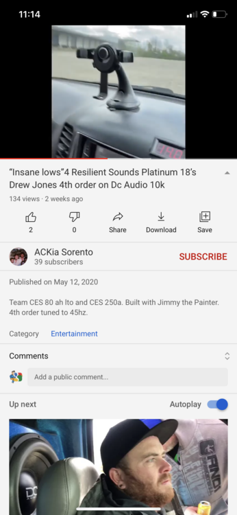

1point21gigawatts Posted June 2, 2020 Report Posted June 2, 2020 14v on hair trick notes. Check the stats too. By the way, that’s not the dude I was talking about with the 2 dc 5ks. “How can we help you?” “And don’t forget to tell them that the customer isn’t always right.”
