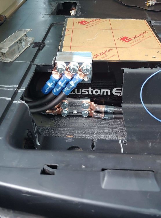

Hopefully we can get a few more comments on feed back Ive been wondering the same thing. I'm getting ready to put 140'  of 2/0 welding cable in my install (5 positive runs from front to back for my 160ah) and I only have a 250amp alt up front. Ive had 5 reputable people suggest 5-6 runs for my 1850 amps of output. I never hear of people having over 100ah or so and not using more then a couple runs but I wouldn't be surprised.

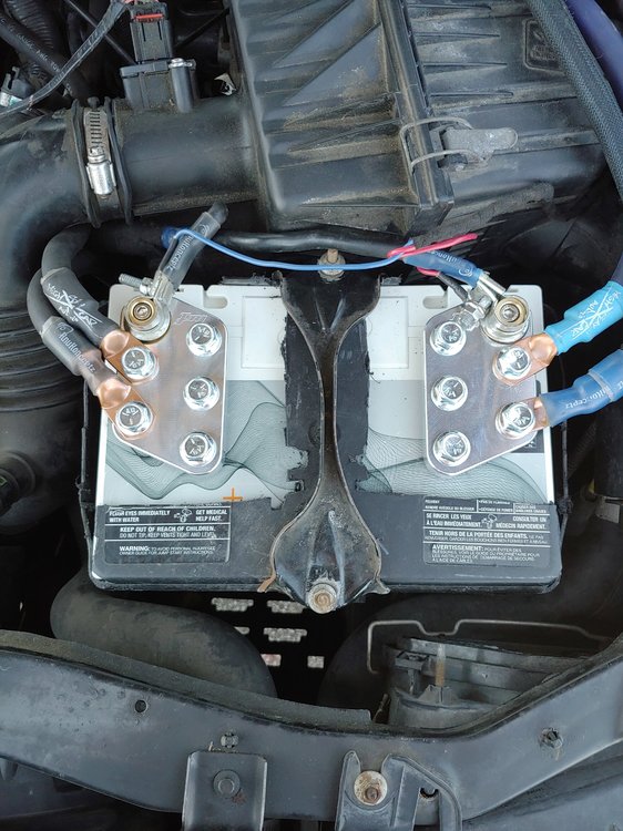

I recently switched to a 40 ah lto bank. I'm using one single run from the front to the rear plus the big four is done.
I have no difference in voltage at the front battery delete terminals then I do at the battery in the rear off the distribution blocks before they amps
