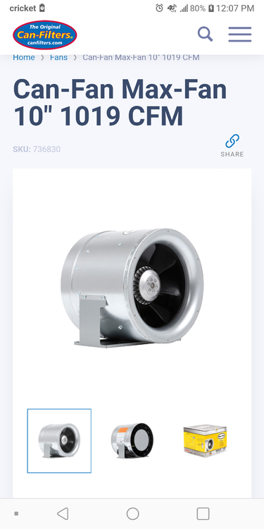

RPM doesn't mean as much as actual CFM because different impeller designs at different speeds can produce more air movement than other designs
Also look into how the fans can overcome static pressure.
I recommend one of these ran on a power inverter because this is a AC fan but you can't go wrong with 1100 cubic feet per minute. Lol
Yea, I totally considered that style, and no doubt they are powerful, but LOUD ! Great for like a wall build with the amps and fans in the back of the vehicle, seperated from the driver / passengers.
I guess if you had a switch and only used it when you were cranking it, or to cool it off between demo's, the loudness might not be too big an issue.
My case fan is like 1/10th the cfm (well now 1/5th, since I have two of them.... But they are whisper quiet and so I run them all the time. Can't even hear them between songs, in spite of the fact they are right behind me 🙂
