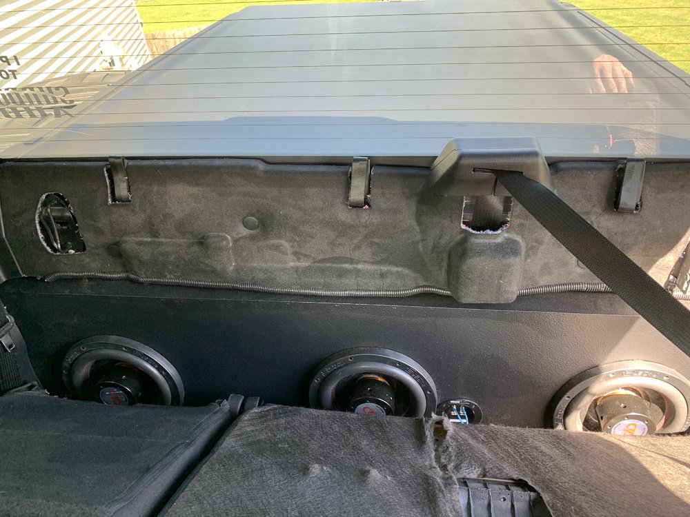

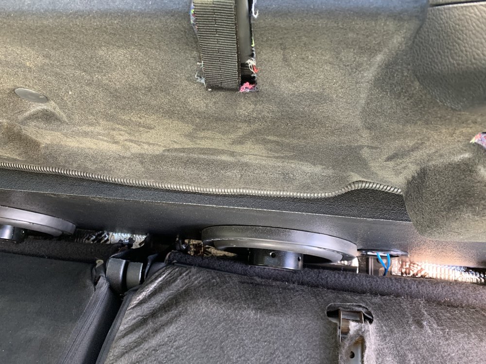

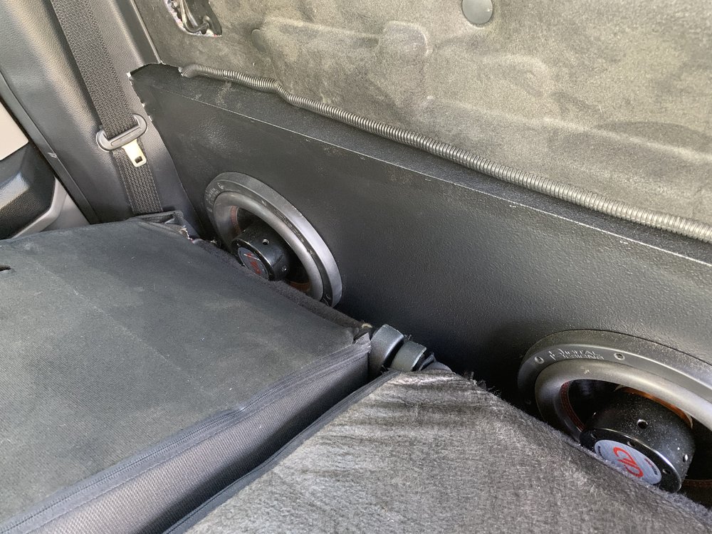

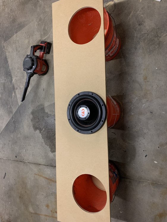

Here’s the system 3-10inch DD slim lines , sealed box stuffed with polyfill . Box is like 1.6 and those subs are on the minimum of the box end. I built it nothing pretty just a rectangle.
This is the only pick I took of the build cause it’s just not that big.

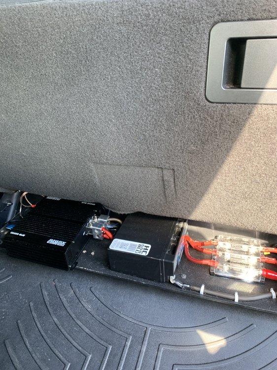

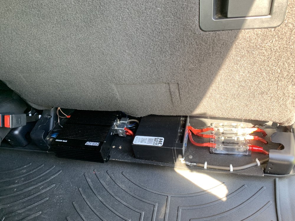

Sub amp and battery setup like I said 10lbs of shit 5lbs bag  just got to make it all fit. I love bass to much and need a truck. Don’t know if I’d recommend the subs they pound for 3.75inches deep but at $350 each only if you have no room , but they can take power and I love DD , didn’t expect a cheap sub from DD and they are not cheap I’ve run Sundown SD3’s and Skar VD 10’s finally found something close to a real sub.
I know sorry it’s 4gauge but 2 runs and dual inputs on the amp I just had like 100ft of 4gauge laying around will probably update it soon cause it does bother me.
The runs are so short that a lot of current can be supported through them runs. More than the amp can pull. That’s no reason to be sorry. That’s ideal.
