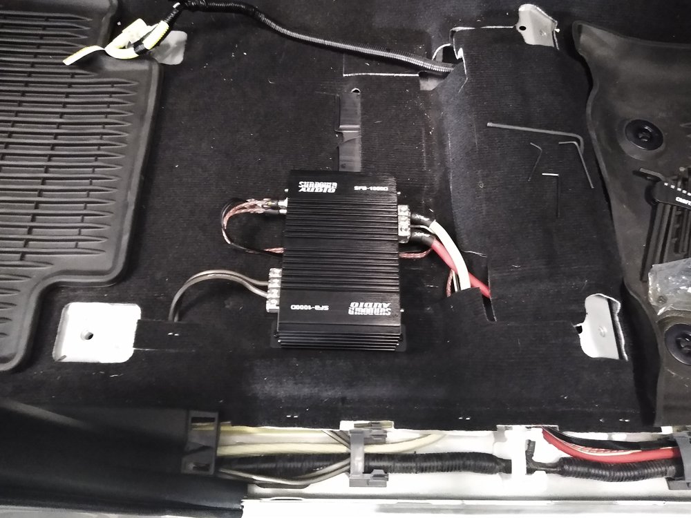

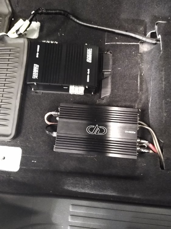

Backwoods Posted June 26, 2020 Author Report Posted June 26, 2020 Got the amp this morning and installed it. Downloaded a frequency generator app for subwoofer testing and used that and a DMM to help set the gains. The DMM method works great really... If you do it correctly, it sets the amp right below clipping. With both amps, 1-1.5 volts more created clipping and I could see the clip meter light up. Anyways, doubling the power made a very noticeable difference, especially at lower volumes. Glad I got this new amp. I'm happy with the output and don't feel the need to get new subs. Don't know what I'll do with that DD amp now. It's a great amp, only been used a couple weeks... I just wanted more power. Singer 250amp Alt, Singer PCM bypass harness Titan8 Lithium Underhood safe BCI PWR-S5 Big 3 W/ dual runs of power/ground. All 1/0awg OFC SounDigital EVO 5K amp, Two 15" Fi SSD subs Next Level Fabrication @ 7 cubes net, tuned to 32HZ

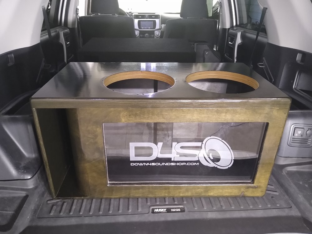

Backwoods Posted June 30, 2020 Author Report Posted June 30, 2020 Got a new box today... For 2 12” subs. Too good of a deal to pass up. Now I need some 12s Singer 250amp Alt, Singer PCM bypass harness Titan8 Lithium Underhood safe BCI PWR-S5 Big 3 W/ dual runs of power/ground. All 1/0awg OFC SounDigital EVO 5K amp, Two 15" Fi SSD subs Next Level Fabrication @ 7 cubes net, tuned to 32HZ
Backwoods Posted July 2, 2020 Author Report Posted July 2, 2020 2 12" SA classics, and the SFB2000D have been ordered. With this box, i think i will love this setup. I will prolly run the SAs on the sfb1000d for a week or 2, let them break in a little with lower wattage and just to see how they do with 1000 rms. Then I will do big 3 with 0awg wire at the same time i install the 2000d amp and run some 0awg for the new amp, since i currently have 4awg to the 1000d. I will see how my electrical handles it and then see if i need to add another battery or just change out the main battery or what. Hoping i wont need a new alternator. You guys are ALL BAD INFLUENCES. Singer 250amp Alt, Singer PCM bypass harness Titan8 Lithium Underhood safe BCI PWR-S5 Big 3 W/ dual runs of power/ground. All 1/0awg OFC SounDigital EVO 5K amp, Two 15" Fi SSD subs Next Level Fabrication @ 7 cubes net, tuned to 32HZ

Backwoods Posted July 2, 2020 Author Report Posted July 2, 2020 Just now, 1point21gigawatts said: Lol! Let me borrow your debt card. You probably make more money than me and definitely spend less than me on car audio. I live on military disability... So HOPEFULLY you make more than me LOL So which of these 2 is actually better? Singer 250amp Alt, Singer PCM bypass harness Titan8 Lithium Underhood safe BCI PWR-S5 Big 3 W/ dual runs of power/ground. All 1/0awg OFC SounDigital EVO 5K amp, Two 15" Fi SSD subs Next Level Fabrication @ 7 cubes net, tuned to 32HZ
