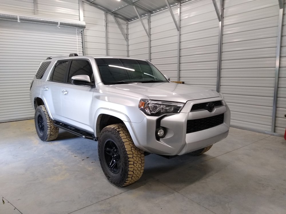

Mods include magnaflow exhaust, full suspension lift with 33" tires and new wheels, BMC, bumper trim, full weld on sliders, skid plates, dark tint, blacked out emblems, LED interior lights and a few other odds and ends.

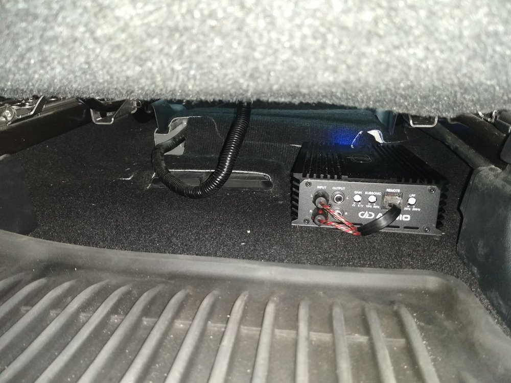

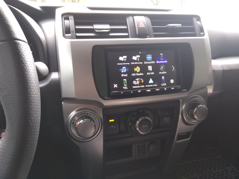

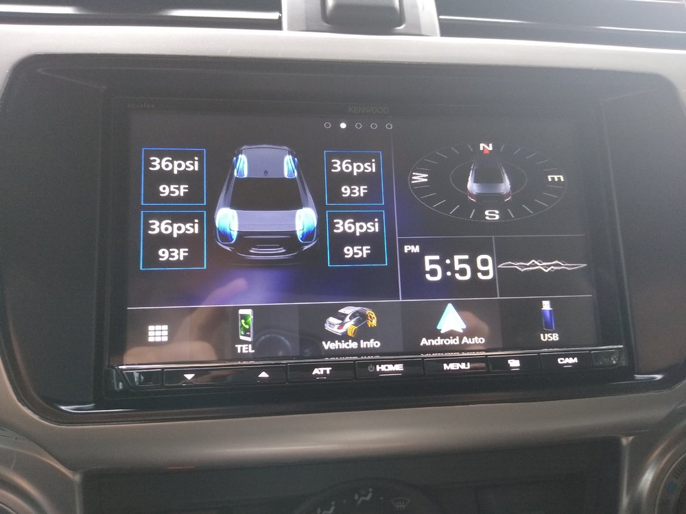

Kenwood excelon DMX907s headunit with idatalink maestro. double USB input replaced stock USB/Aux input. All doors and rear hatch speakers replaced with Kenwood KFC series speakers.

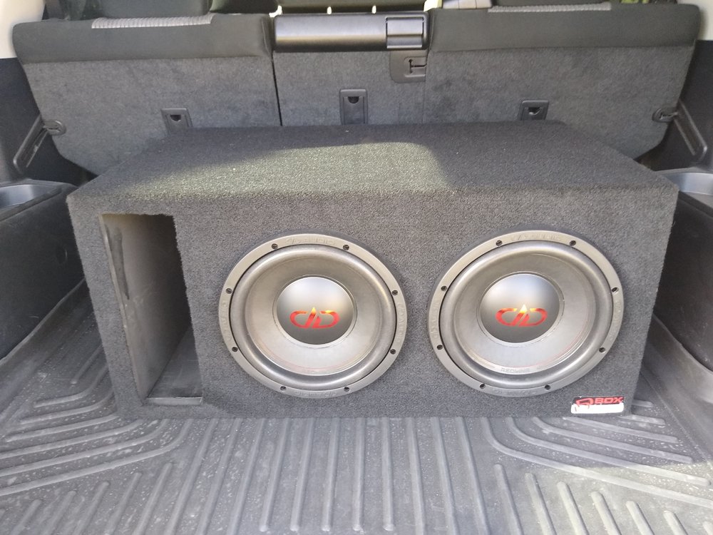

DDaudio 10" (entry level 200 series) subs in the back with a DDaudio 500 watt rms amp installed under front passenger seat.

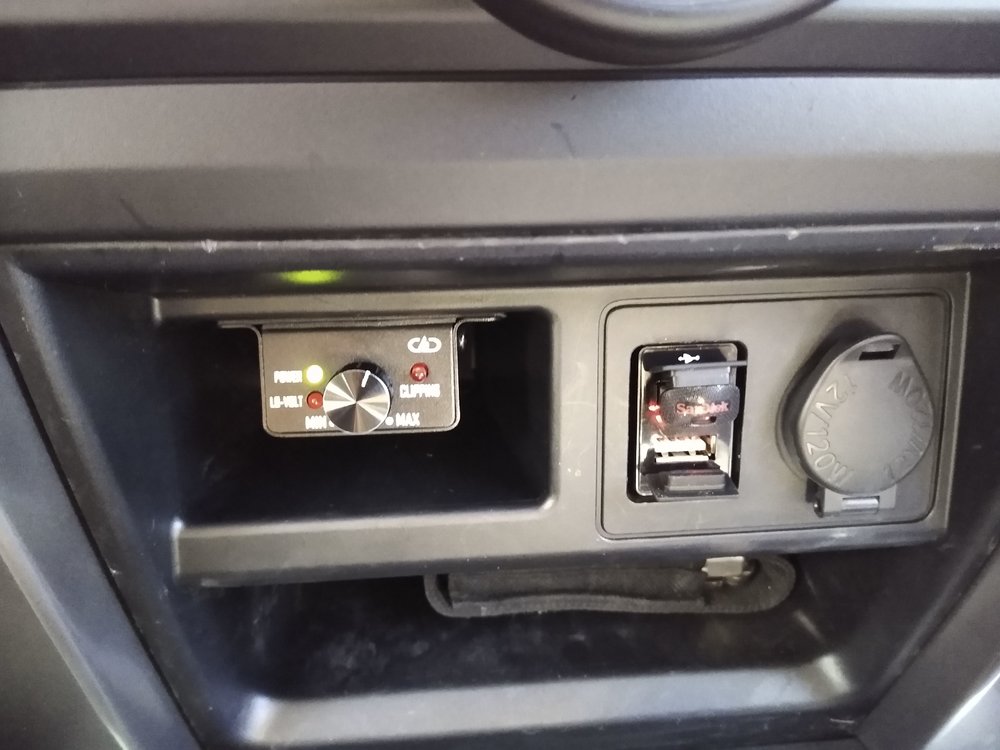

Bass remote installed in the worthless cubby hole on dash. Stinger X, 4ga ultimate wiring kit and stinger 4000 RCAs.

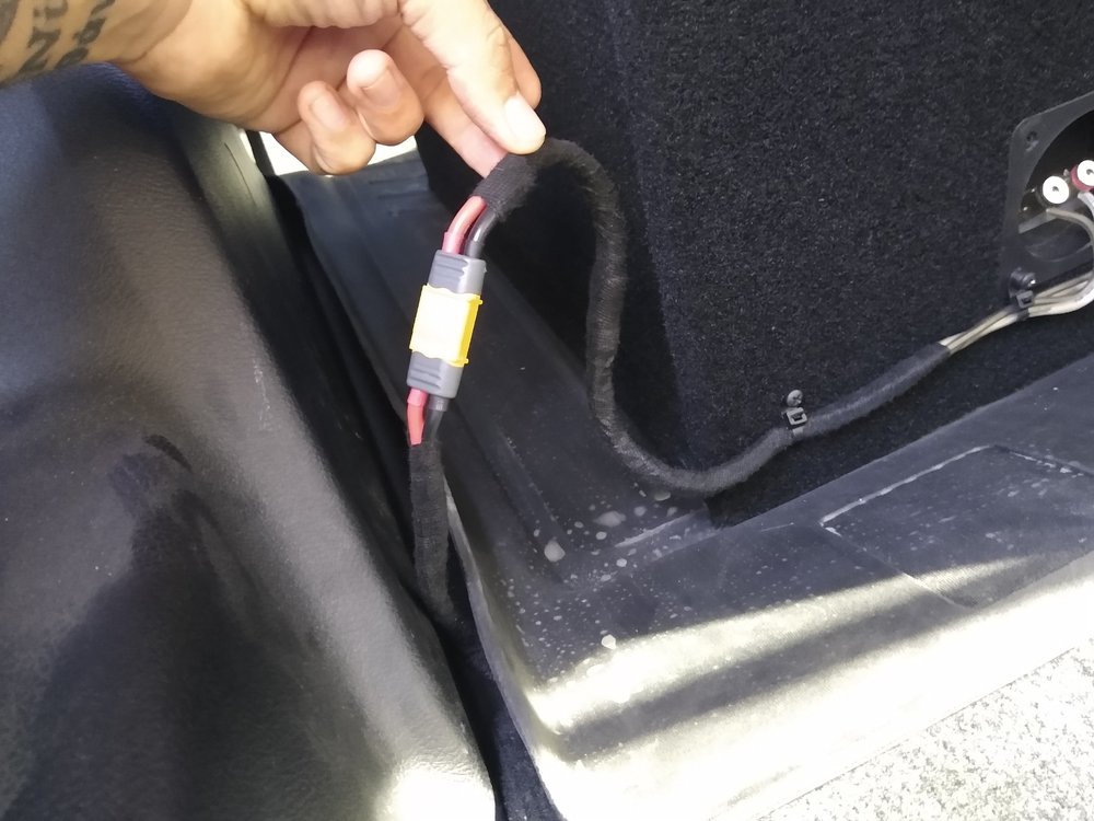

Quick disconnect added to subwoofer box with an XT60 connector. Makes removal quick and easy for when I need all the cargo room.

And yes, I'd like a little more. But want to keep the same box and amp location. I'll likely be ordering the sundown sfb 1000d soon. And if the subs I have now can't handle that, I'm thinking maybe the sundown E series 10s might be good fit with that amp. But I'll try the DDs for a while first.

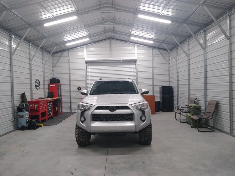

In my garage/man cave... And @Ron36 I read on another post that you're a technician... So you might like the second picture... A buddy of mine cut that out with his laser for my garage bar.
17 minutes ago, 1point21gigawatts said:
The car audio build is clean, for sure. But what I like, is the garage. It’s nice how it is but has so much potential.
Thanks. It's wired for a 2 post lift, and a welding station... And concrete is reinforced for the lift as well... But I never got around to setting up either. The wife and I are debating if we plan on moving one more time or staying here forever. I don't want to get it perfect and then we move LOL

The SFB1000D has been ordered.
And I've been debating between the sundown 10" E series (500rms each) or the SA series (750 RMS each) to go with that amp if I decide to switch subs. The SA series obviously look better, but they'd be underpowered. The E series would be better matched up with RMS, but not as good of subs.
But the question is, would the underpowered but higher quality SAs still outperform the properly powered E series?
Either way, they'll be in 1.5 cubed each ported and tuned to 30. So slightly bigger box than suggested, which is good for underpowered subs I believe....
I would get the sa’s for sure. They are built like tanks and in the future you you could put a sfb3000d on them, easy with no problems or worries. Them sa’s are the sh!t would still be hungry on that sfb3000d. But once you learn more then you can push the envelope a little more. Sundown subwoofers do better in larger enclosures and can still handle double or triple the rated rms in a larger than recommended enclosure.
