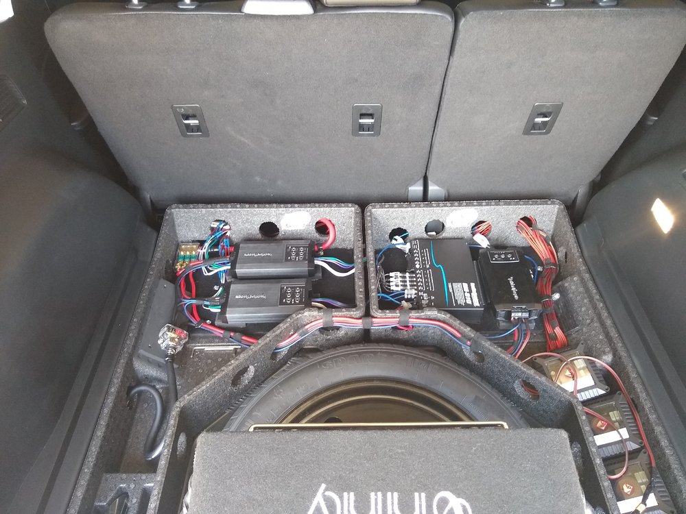

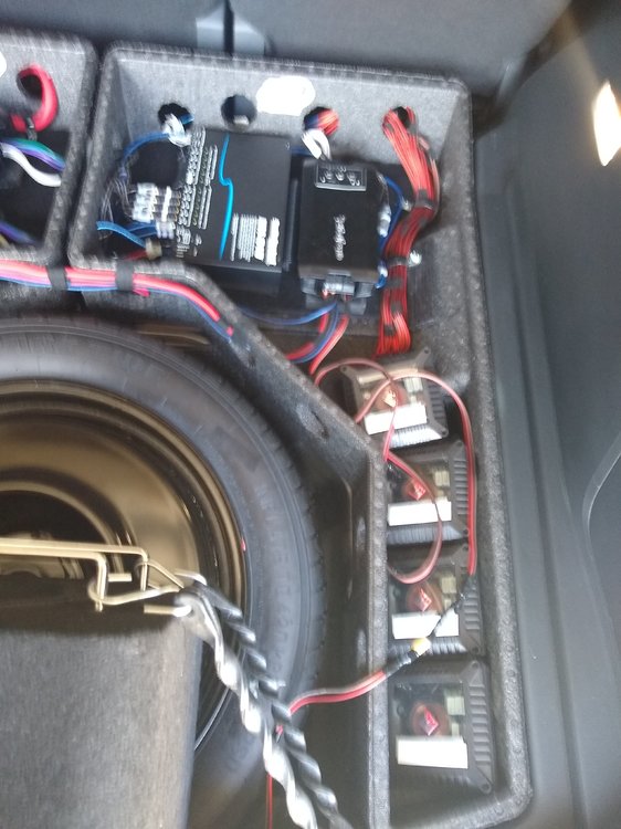

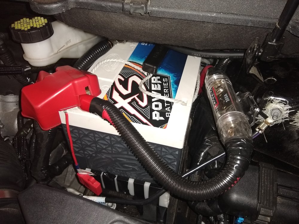

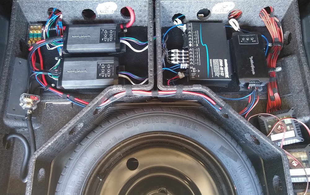

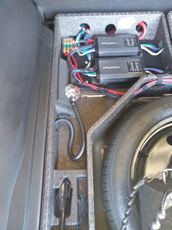

Ampped up Posted July 8, 2020 Report Posted July 8, 2020 To Be clear......there are (2) 4 channel amps at 100 watts per each, 800 watts here, then a sub woofer amp operating at 500 watts. A DSP running there too. So this is 1300 watts as far as I know. Powering 2 pairs of Rockford Fosgate power component speakers with a 12" sub. Not the typical 7 SPEAKER installation but wanted all the speaker holes plugged. The center dash speaker I left unplugged. I fit all this crap into the the area around the spare tire some how. It looks decent too but really do not want anyone knowing its there. There is no way to tell theres any up grade, thats what I want because the car is parked out on state land some times for a while. The car battery is a AGM TYPE XS D3400. This actually made a huge difference but fights the battery management system a bit. It rests at about 13 volts normally. I can say with 110% cetanty that car manufactures want you to buy there upgraded systems. They have arranged the fuse panels way up in the dash now on most newer vehicles. Molded side plates into the fuse panel to block you from adding a fuse tap etc. The newer battery management system is a real pain in the ass. I really do not want to do any big three up grades if i can avoid it. Could maybe cause other issues. The pcm is so locked in to everything now compared to the 2010 model ford escape I had. No battey management system, fuse panel right behind the fuse door. Thank you for all your replies. I am the newbe here, If you want to get get your arse kicked you have to go over to the hunting forum and i can do it there. L.O.L. I am so glad to here someone say....."You dont need an alternator."
Ampped up Posted July 8, 2020 Report Posted July 8, 2020 herss my first ever install, 14 ofc ga in the doors too.
