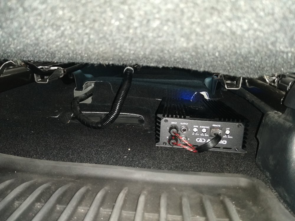

Backwoods Posted June 26, 2020 Report Posted June 26, 2020 Just replaced a DD audio 500rms amp with a sundown 1000rms amp. The RCA input on the amps is totally different. DD has 2 sets, one for input one for output, then a left and right channel for each... Easy. The sundown has one set, and one plug is labeled as input and one plug is output. No colors or anything. So how do I know which RCA plug goes in each one? I was using the red as right channel on the DD amp. Pictures should further clarify. The amp I replaced.... Singer 250amp Alt, Singer PCM bypass harness Titan8 Lithium Underhood safe BCI PWR-S5 Big 3 W/ dual runs of power/ground. All 1/0awg OFC SounDigital EVO 5K amp, Two 15" Fi SSD subs Next Level Fabrication @ 7 cubes net, tuned to 32HZ

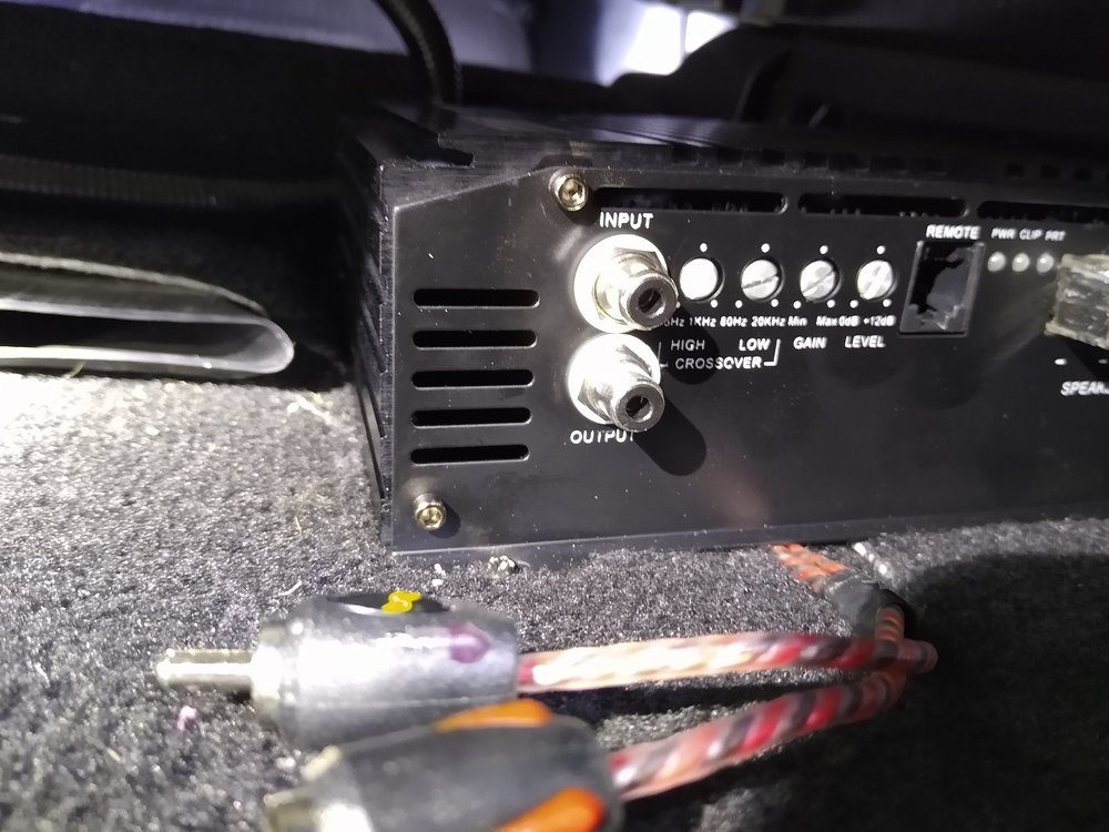

Backwoods Posted June 26, 2020 Author Report Posted June 26, 2020 The new amp... Singer 250amp Alt, Singer PCM bypass harness Titan8 Lithium Underhood safe BCI PWR-S5 Big 3 W/ dual runs of power/ground. All 1/0awg OFC SounDigital EVO 5K amp, Two 15" Fi SSD subs Next Level Fabrication @ 7 cubes net, tuned to 32HZ
MrSkippyJ Posted June 26, 2020 Report Posted June 26, 2020 get a y addapter and plug both signals into the INPUT side F150: Stock 2019 Harley Road Glide: Amp: TM400Xad - 4 channel 400 watt Processor: DSR1 Fairing (Front) 6.5s -MMats PA601cx Lid (Rear) 6x9s - TMS69
Backwoods Posted June 26, 2020 Author Report Posted June 26, 2020 1 minute ago, MrSkippyJ said: get a y addapter and plug both signals into the INPUT side Thanks. I'll get one... I've already tried it playing with these put in both ways, would that hurt anything? .. I didn't notice any difference in sound. What was happening with them plugged in one in input one in output? Singer 250amp Alt, Singer PCM bypass harness Titan8 Lithium Underhood safe BCI PWR-S5 Big 3 W/ dual runs of power/ground. All 1/0awg OFC SounDigital EVO 5K amp, Two 15" Fi SSD subs Next Level Fabrication @ 7 cubes net, tuned to 32HZ
MrSkippyJ Posted June 26, 2020 Report Posted June 26, 2020 you won't hurt anything by only plugging one side into the INPUT side, with the exception of the rare times the bass channel is actually recorded in stereo. As far as plugging one into the OUTPUT side, i'm not sure what happens. F150: Stock 2019 Harley Road Glide: Amp: TM400Xad - 4 channel 400 watt Processor: DSR1 Fairing (Front) 6.5s -MMats PA601cx Lid (Rear) 6x9s - TMS69
Backwoods Posted June 26, 2020 Author Report Posted June 26, 2020 Thanks. I'm seeing if any local stores has any y adapters... I'd rather get one now than ordering one. Singer 250amp Alt, Singer PCM bypass harness Titan8 Lithium Underhood safe BCI PWR-S5 Big 3 W/ dual runs of power/ground. All 1/0awg OFC SounDigital EVO 5K amp, Two 15" Fi SSD subs Next Level Fabrication @ 7 cubes net, tuned to 32HZ
Backwoods Posted June 26, 2020 Author Report Posted June 26, 2020 Local shop that installed the head unit for me advised against connecting both RCA into the one amp input with a y adapter, said it could overheat the headunit... They said only run one RCA into the amp... They wouldn't even sell me the Y adapter because they said they don't want the liability of me burning up the head unit since they offer lifetime warranty on install... I know lots of radios only have 1 RCA output for subs.. mine has 2... I doubt it's best to only plug one in... Seems like I wouldn't be getting all of the signal. Singer 250amp Alt, Singer PCM bypass harness Titan8 Lithium Underhood safe BCI PWR-S5 Big 3 W/ dual runs of power/ground. All 1/0awg OFC SounDigital EVO 5K amp, Two 15" Fi SSD subs Next Level Fabrication @ 7 cubes net, tuned to 32HZ
MrSkippyJ Posted June 26, 2020 Report Posted June 26, 2020 one is just fine. Most sub channels are mono anyway. I'm not sure how it would hurt it to run a Y adapter but one is just fine and there won't be any signal loss. F150: Stock 2019 Harley Road Glide: Amp: TM400Xad - 4 channel 400 watt Processor: DSR1 Fairing (Front) 6.5s -MMats PA601cx Lid (Rear) 6x9s - TMS69
