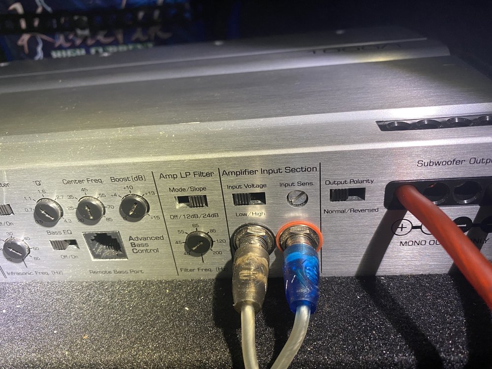

nvm i couldn't see the slider very well looks like the bass eq is off so the Q control isn't doing anything
I would turn the infrasonic frequency to about 30 Hz
Did they tell you what the enclosure is tuned to?
probably a good idea to also check the screws themselves on power and ground give a small tug not too much but you shouldn't be able to pull them out with ease.
What is the filter frequency set too under the amp LP filter section?
skar sk2500.1

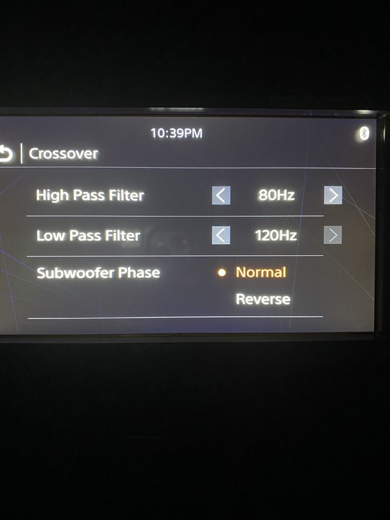

alpine HU

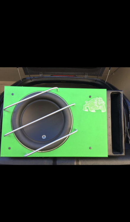

2 x-15 sundowns

I just read the manual. It recommends a 100 amp fuse for a single 1000/1 and a minimum of 4 gauge power and ground wire. So you should be good there. If you want to up the fuse to 120, I don't see the harm in that. Something is making your amplifier try and overwork itself. The manual states quite matter of factly, 4 gauge is the ONLY recommended size power and ground per single 1000/1. So yeah, I would think it was a connection problem somewhere or the settings on something could be waaaaaaay off somewhere
@Dafaseles I went based off of the manual for the settings They just tuned the gain. I believe something is making it overwork, I’m leaning towards the ground @1point21gigawatts had a good point of it being grounded to a piece of metal welded to the chassis rather than the chassis itself

@Dafaseles I’m going to look into that area. The screw on my ground just turns and turns like it’s not fully tight I would assume since it just turns & turns so now that I seen the other guy mention that it is just a piece of metal I think that is the real problem here. Do my amp settings look fine you think? Thanks a lot
