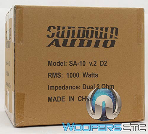

ohruma Posted July 17, 2020 Author Report Posted July 17, 2020 18 minutes ago, 1point21gigawatts said: Did y’all know that the rev3 is a v2? There are only 2 version (v) of sa subwoofers, v1 (classic) and v2. The rev3 is the newest revision (rev) of the v2. If you go on sundowns website you will see that there are only 2 versions to pick from unless you get the 8” which they have came out with a v3 on that size. I've actually looked into that a lot to clear my own confusion being in the market for them currently... SA Series Rev.3 was the last revision of the V.1 which is now being sold as the SA Classic due to popular demand. The V.2 is still on its original first revision if you would even call it that considering nothing has been revised from launch earlier this year.SA Rev.3 and Classic are the same thing [750RMS] and the V.2 is the newer model [1000RMS] Source:
ohruma Posted July 17, 2020 Author Report Posted July 17, 2020 SA V1 Rev.3 (Classic Pre V.2 Launch) SA Classic (V1 Rev.3 Post V.2 Launch) SA V.2 All in all irrelevant though the question still stands... are the new V.2 subs improvements worth the extra $90? I'm not worried about under-powering or anything there will be revisions to this system to push it harder over time. I wouldn't wanna reach the limits of the Classics and regret not forking over the extra $180 on the set of V.2s

ohruma Posted July 17, 2020 Author Report Posted July 17, 2020 8 minutes ago, 1point21gigawatts said: You are correct, my friend. My brain has farted and I was mistaken. It happens sometimes. I forgot that they made a rev2 and then a rev3 and then the v2. I thought it was backwards for a second until you said something and I thought about it. But I know you could use the v1’s from 2009 when they came out and still put them on 3000rms daily and they would never blow as long as you were sending them a clean unclipped signal. So, any version or revision of the sa subwoofers could handle that amount of rms and never blow as long as the signal was clean. I'm leaning really hard towards the V.2 but my only main draws are the looks and 1000rms rating which I know if Sundown says 1000rms its really more in the 1500rms, like you said even OG SA series subwoofers could take whats that... 200% their rating in power? The V.2 also just look beefier in general and of course on paper looks quite a bit better. But like Backwoods said you probably wouldn't notice the difference in terms of daily listening. It really seems more of a question of saving money with tried and true or forking over the extra for shiny and new. With Sundown luckily I can't technically lose out either way.
1point21gigawatts Posted July 17, 2020 Report Posted July 17, 2020 The v2 has a bigger voice coil, stronger motor and better soft parts than the v1 revision 3. So it can handle more. 2 of the v2s can handle a salt-4 or a md5000.1 without any problems. When it comes to underpowering them subwoofers like you plan on doing, they will be NO difference whatsoever between the v1 and the v2 because you would be underpowering either one. That 1500rms Skar amp only puts out about half that amount of rms after impedance rise and voltage drop is factored in. So each of them subwoofers are gonna be seeing about 400 rms a piece. You would only worry about which one of the sa subwoofers to buy if you were planning on using more rms. On that Skar amp, really there isn’t any reason to get more than one sa subwoofer. If you want to get 2 subwoofers on that amp then pick a model below the sa. If you want to get 2 sa subwoofers then pick an amp that puts out more rms. If you want a cheap amp and want to match the subwoofers then get an sfb amp and some sa classics. “How can we help you?” “And don’t forget to tell them that the customer isn’t always right.”
