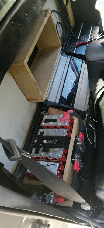

Think im running out of room. IMG_20211008_063650.thumb.jpg.e6f78e96b5e53a59475536eedc255db3.jpg
Passenger seat delete 😆
06 Charger
Pioneer double din
Pioneer 6.5 and 6×9's
0 ga knukoncept kolossus wire
Big 3 same wire ^ 1 run
8g karma ss speaker wire
Sundown sia 3500d at 1ohm
2 Sundown U series 12's
Xs power d3400
Trying to find a ho alt
Looks damn good to me though!
Can't take pass seat out, daughter rides sometimes. Could always mount things to the beauty panel. Box is 1.5" thick so that pannel dont move. Could always mount up under the dash, move center console and mount standing, in the bed since i got a shell.
Got it all figured out

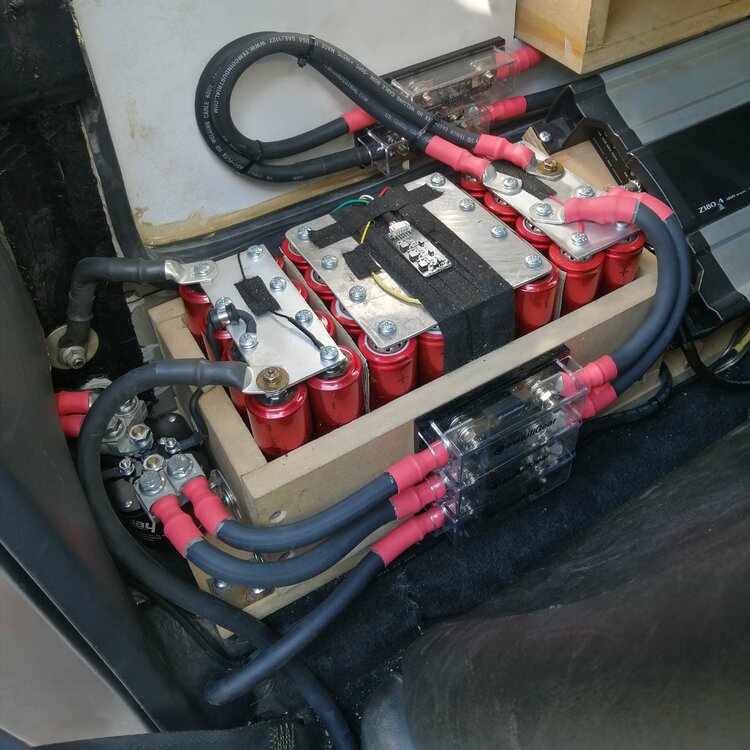

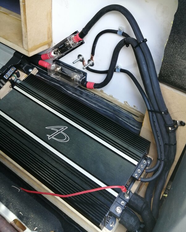

No good way to do wiring so I just ran it like that. IMG_20211010_140642.thumb.jpg.94ed62ba712683c3b386df343be68408.jpgIMG_20211010_140724.thumb.jpg.4772b978e06fbff52bf410725e528e1a.jpg
Looks clean to me! With all the space constraints, gotta do what you gotta do!
